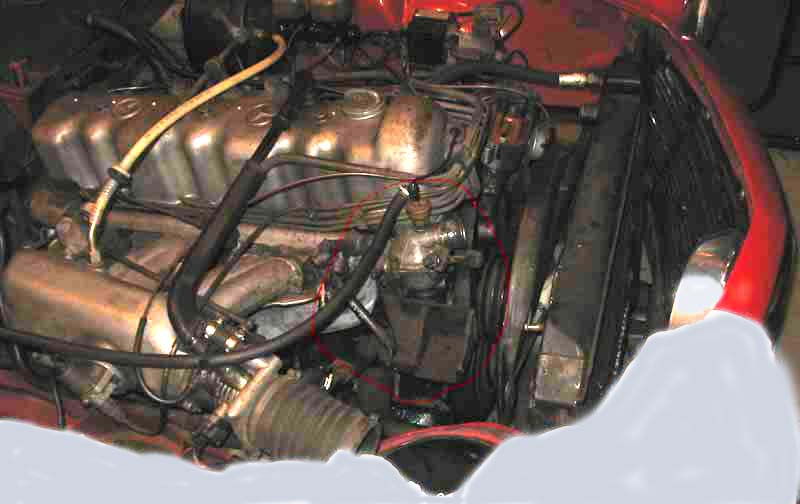

I'll try to attach some pictures tonight, to make this all seems clearer.
Any and All help would be huge, I'm really worried about this project. Thanx!
Photo "sideview" edited to show more deatil by Admin 5/11/04

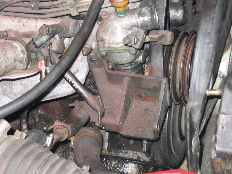

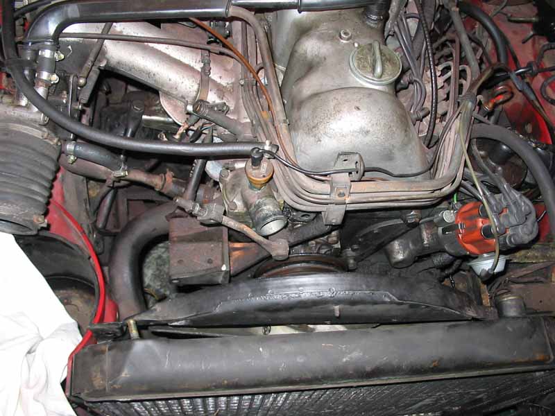

Wow, am I ever having a hard time attaching these picture images. Ah, ha! I have to use Internet Explorer. I guess the uploader doesn't like Netscape.
anyway... The BBB shows a different v-belt configuration than my car has. BBB shows the A/C on the top passenger side of the engine, and the alternator below it. My engine has just the opposite. A/C down below, and Alternator above. The Haynes 230/250/280 '68-'72 tells me nothing about belts (both cooling and alternator sections). It shows the alternator with a totally different bracket and different mounting location. The Chilton Repair and Tune-Up Guide '68-'72 MB2 doesn't help either. Am I screwed?
Any help?  What v-belt to use now? How to install/tension. How to get this bracket off so I can locate the leak? Are all heater hoses same diameter?

William - I'm pretty sure you need to move the alternator bracket to down below on the block like the BBB says. The bracket attaches with two bolts directly to the block. You want to make sure it's the right bracket for the alternator in that spot. Then I believe there's one fan belt that drives the water pump and the alternator, with the latter acting also as the adjuster for the belt tension. Then there is usually another belt for the power steering pump, but I'm not 100% sure about this. I can check when my car and I meet up later today.

Well, with all of your help, particularly George Des, I've gotten the huge heavy alternator-A/C bracket off the car. Shew, what a job! Isn't there anything easy to do on this car?
My friends at http://www.online-mercedes.com have located an alternator bracket for a w113. Since I've never seen it, I can't really tell if this is the right thing. They thing it is. I was wondering if any of you could look at it, and maybe look at yours and see if they look the same.
Cees, I could still really use pictures showing where it mounts. Folks have mentioned using SLS's web site to see diagrams of where this goes - but I jsut can't seem to find anything on their site that shows me - and the BBB has no diagrams or anything that tells me. Am I just a big dummy or what?

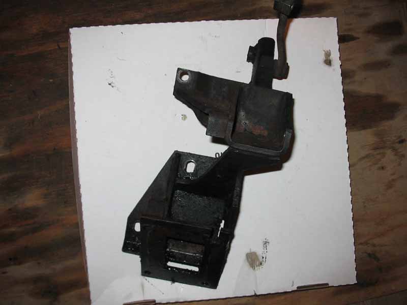

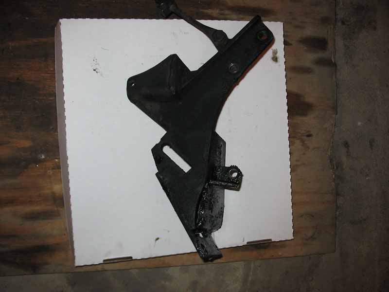

Well, now that I'm getting the hang of uploading this pictures, I'm going bonkers with it, ey?  Just thought I'd share a couple of shots of the albatross bracket.
I have only one piece of advice for anyone out there that has an SL113 equipped with this monster:  Run away!

sorry I could't jump in sooner, I have been just too busy. I wanted to tell you about that 17mm bolt hiding in that recess of that bracket!
Anyway it looks like you got it off, good job. Yes that is the right alternator bracket. It is fairly common as it is also used on many of the era sedans. You may need different length bolts to hold the water pump on as I recall. Be sure to use threadsealer on of these bolts goes into the chain gallery. Check the mounting studs for the bracket on the block to make sure they will be the right length. A special "shoulder" bolt is used to mount the adjuster arm, you may have the right one from the old bracket. The non AC waterpump pulley will be different (less grooves if I recall?) but you may be able to work with the one you have.
That small hose under the thermostat housing is refered to as a thermostat "bypass hose" it has it's own parts number and has a slight bend in it. The part number I have is #127 203 0082. This number may have been updated.

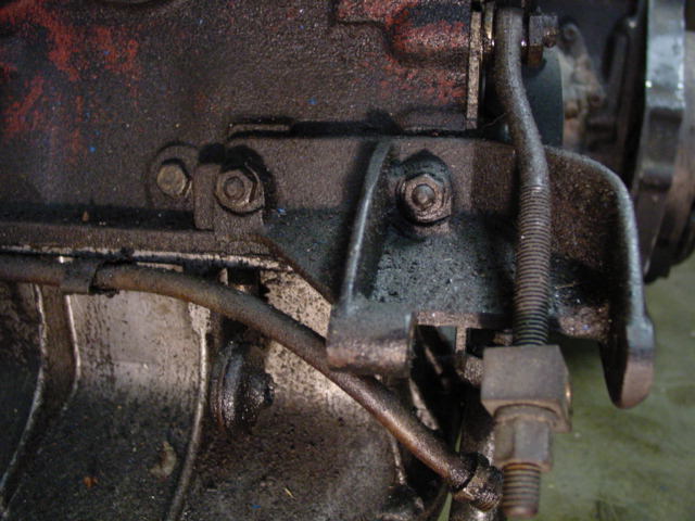

I will take these pictures on Saturday. That is the correct mounting bracket as Joe points out, and it should be an easy installation (particularly after all you've gone through with the old elephant bracket).
There are many easy jobs on the car, but let's start a thread on the hard ones, so we're all forewarned. I will do that next.

The standard alternator bracket bolts right to the block without spacers. I think the AC studs may be longer than the studs for the standard alternator. You may have to change them or use some spacers on the outside of the bracket.

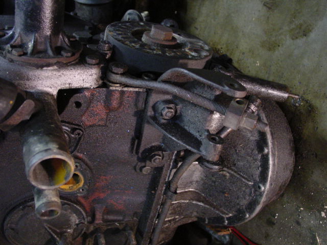

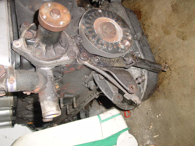

Here's the photos (emailed separately to Blair) for the group:

What's that cylinder-like thingy hanging below the alternator bracket in Cees's pictures (assuming engine was right way up)?? :?:
knirk
Re: HELP: coolant leak & v-belts nightmare!!!!!
« Reply #18 on: May 18, 2004, 05:58:11 »
Looks like an engine damper. I havn't seen this on the 113, but it is used in later MB cars. There were one or two on my R 107.
Per G. Birkeland
69 280 sl aut 834
Norway
  • Posts: 5874
« Reply #19 on: May 18, 2004, 11:54:58 »
This engine is from a 280 SE sedan, so that's the explanation!
