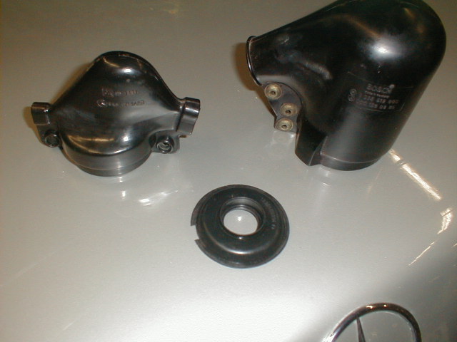

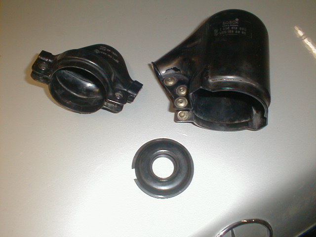

In any case, these are somewhat rare these days since they are often removed and lost over the years. View the three piece set below.
Download Attachment: ignition covers 1.jpg
56.8 KB
Download Attachment: ignition covers 2.jpg
55.96 KB
The early version which is most correct for the W113 cars has the rarer metal snaps. The later version (Possibly after W113 production)had plastic snaps.
These covers are good waterproofing for owners who like to wash down their engines.

I fitted new covers but I think the distributor cover is not as deep as the old one with metal snaps.
The internal cover is the most difficult to find (unless you have a source)!! May I have the part numbers off the items please. Couldn't read them off the pictures.

Here are the part numbers you asked for; distributor cover (metal snap type) is Bosch #1 235 510 000 MB # 000 158 0685, The coil cover (plastic snap type) Manufacturer #SP 1331 MB #000 158 1485, internal point cover Bosch #1 230 500 094 (no MB #).
I appears the early injected engines without the distributor boot, had the spark plug cables routed above the metal injection lines. I can't say for certain. Later engines with the boot definately had the spark plug cables routed below the metal injection lines.
