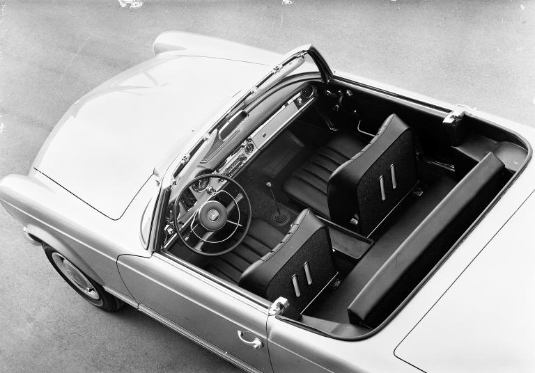

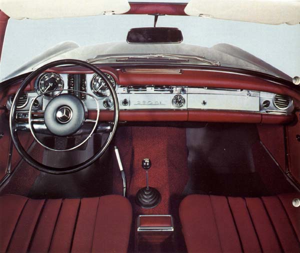

Attention to all you sun visor-color-changing people!
I believe the correct color of the sun visors is that very light color that you think does not match the rest of your interior.  Actually, they match the color of the headliner in your hard top.  The original soft tops also had this same color liner in them, regardless of the exterior color.  So if you have good hard top and soft top liners, the sun visors should match them.
I could be crazy, but here's a few pics to back up my statement:
Whole interior color v. sun visors:
Download Attachment: 230sl_interieur.jpg
9.07 KB
Dash color v. sun visors:
Download Attachment: 250 SL cul.jpg
34.17 KB
Download Attachment: 280 sl Interior1.jpg
42.02 KB
Look at the dash instrument cluster material v. sun visor:
Download Attachment: Pago verd classic d.gif
41.54 KB
Download Attachment: vista interior.jpg
58.96 KB
Of course you can find many pics of sun visors that match the interior, but I believe it was original to match the top liners.
