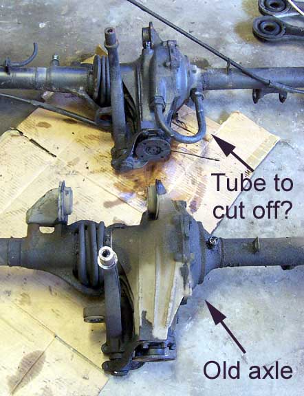

A vent on the differential housing????? Is it there because the air expands as the differential gets hot while driving??? Is there a filter, cause it seems to me you do NOT want to get dirt in there! Could someone post a drawing or a picture???
  • Posts: 4921
Re: Rear Axle Vent Location
« Reply #3 on: April 02, 2004, 06:45:11 »
www.sl113.org/forums/uploaded/johnlivingston/200437154157_rears_compared.jpg
This link was buried in this thread:
www.sl113.org/forums/index.php?topic=1195
