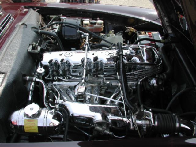

Here's another waY to do it if you have a bulging wallet:
Download Attachment: ChromEng

« Last Edit: March 20, 2004, 13:52:46 by naj »

I have never seen any of these cars with painted fuel injection lines and linkages.  They were certinly all plated.  It is possible the early cars were cad plated without yellow dichromate added or they were not heavily dichromated.
I have been collecting sales literature, magazine articles and personally looked  at literally hundreds of pagodas over the past 24 years.  Many of the cars were low mileage original cars from 1964 to the end of production.
The heavily polished and chromed pieces in the photo, while pleasing to most uninitiated eyes, would suffer poorly when judged against one it's peers at a concours or car show.  I have even seen one car where the owner polished the underside of his aluminum hood.

Is it possible that engines were 'dressed' differently for different markets?

I was finally able to get the picture from the URL to print.  This is exactly the same picture I have in my collection.  It came out of a 1968 280SL Prestige sales brochure.  These brochures are extremely rare, so it is great that we all have this photo to view.
The photo tells it all.  It does not lie or leave anything to conjecture.  This is the way they all looked when new.
I rest my case.

I guess anything is "possible", but I would bet money that almost everyone would say that your car is the first they've seen with painted fuel lines, etc.
