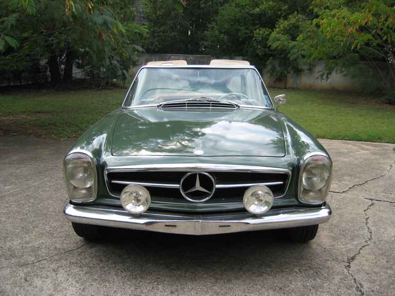

Mine was originally delivered without extra driving lamps. Because of the rallying I do I needed extra lights.
I had squarish lamps mounted under the bumper (see first picture) and although they were from the 1960's I didn't like the look. They were Lucas as well... doesn't really fit with a Mercedes. Plus they were much larger than the lamps you have on your car. I had to take care with speed bumps and so on.
When I removed my bumper overriders I bought Hella Classic 160 Chrome lamps, and mounted them in the holes left by the bumper overriders. That means that they are a little close together, but with driving lamps that doesn't really matter, they're angled for rallying as well (the right light a bit more to the right, the left one straight ahead). They do give an excellent amount of light, I use them for normal night driving as well.
Recently I've also been able to buy a set of plastic protectors for them (via ebay) because Hella does not make or sell those anymore.

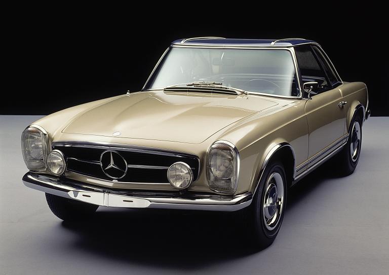

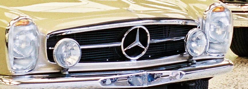

The previous owner of my car imported the car from Germany in 1977 and these Cibie foglights were already installed: waqas230slfogs.jpg, waqas230slfogs2.jpg.
Here is another car in the MB museum: museu2.jpg, Museum-fog.jpg

Here's Ole Beige wearing Hella round on-top-of-the-bumper fog lights. Car color and fog light configuration are much like the Museum car in Wagas' posting above.
I have only seen square below the bumper lights on 107 cars.
My ride is a Euro model with fogs iin the headlights as well as on the bumper. The headlight fog lights and the bumper fog lights are activated when the light switch is pulled out to the Fog Light On position.

The MB museum has a Pagoda with round fog lights.  I believe there's a photo of it here somewhere.

Here is the museum car..
