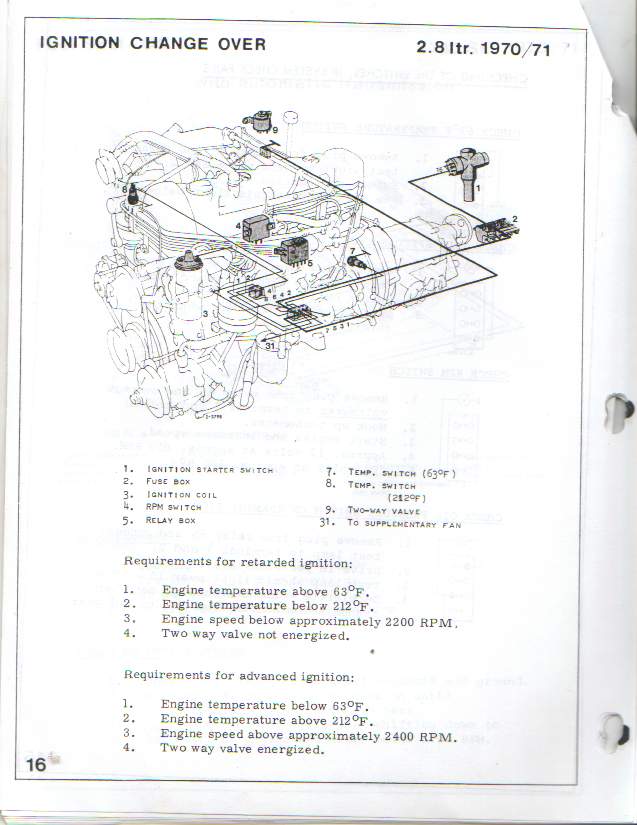

Hello Jeff,
Certain elements of these systems vary from year to year. The ignition changeover systems are mosty unique to USA delivery cars after 1968, I believe. Here is some information which may help you. I also have the information for the previous year if this does not seem to match your car.
Download Attachment: ignition change over.jpg
63.51 KB
Download Attachment: ignition change over 2.jpg
58.97 KB
You will have to click on the enlarge button to make the scans readable.
