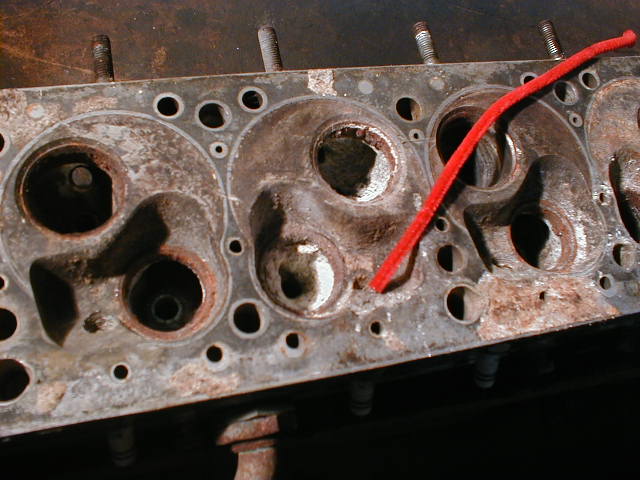

Another very important item to look out for during cylinder head service is corrosion. Coolant eventually turns acidic as time goes on. Mercedes antifreeze is formulated for these engines and to their specifications. Off the shelf antifreeze is ok to use but shorter change intervals are reccomended if factory antifreeze is not used. When coolant turns acidic the engine will slowly start to decay from the inside out. The dissimilar metals begin to eat away at each other and expensive parts like cylinder heads can be ruined.
This picture shows a hole corroded between a coolant passage and the combustion chamber.
Download Attachment: hole corroded in cylinder head.JPG
59.26 KB
The next picture shows the same head with a large portion of the head gasket sealing area gone from corrosion.
Download Attachment: gasket area eaten away.JPG
59.73 KB

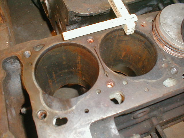

The cyinder block of the 280-SL (M130) engine has only 1/16" sealing surface between coolant and combustion chamber! The sealing surfaces of the block and head must be precise!

If the acid level of the coolant is not checked, all engines should have coolant changes every two or three years. Engines in long term storage should be drained or checked for acid level of coolant periodically.

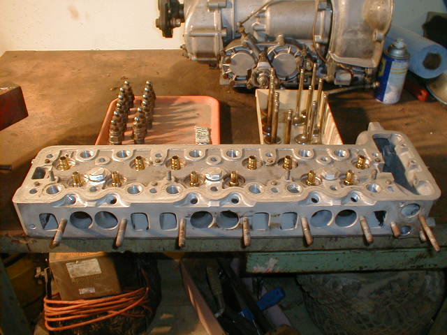

In most cases the complete head along with the valves, springs etc. will be taken to the machine shop for dis-assembly and inspection. After machining it will be returned assembled, less camshaft and rockers. This is probably best, in most cases, for the non professional. I prefere to re-assemble the head myself so I can inspect the work done at the machine shop. This may not be practical for most since some special tools and experience is needed. I will quickly run through assembly so everyone can get familiar with the parts and procedures involved.
At this point the head has been returned from the machine shop cleaned, milled only if needed, new valve guides installed, valves and seats ground, etc.
Unusual problems such as replacement of valve seats, repairing of cross threaded spark plug holes, welding, replacement of broken studs etc. also has been done.
Download Attachment: cyl head with parts.JPG
60.25 KB

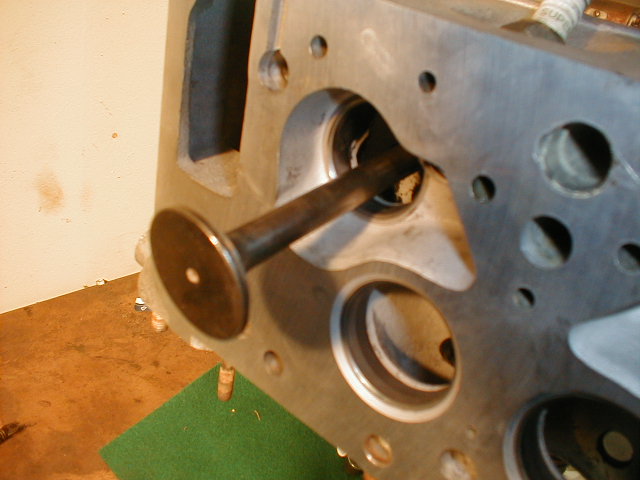

The valves have been numbered for installation after being ground at the machine shop. The valve stem is slightly oiled and installed in the head.
Download Attachment: valve being iserted into head.JPG
58.09 KB

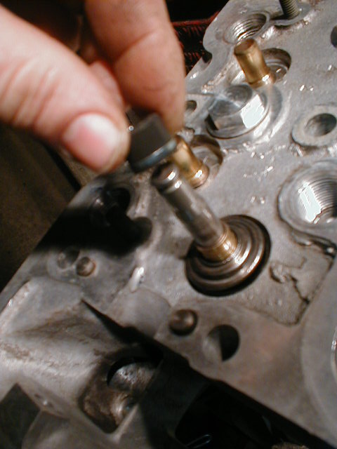

 A valve rotator is placed around the valve guide. (check to make certain all valve rotators rotate freely)
Download Attachment: valve rotater installation.JPG
59.24 KB

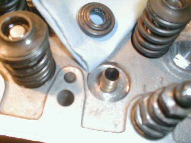

 The new valve seal is installed over the valve stem and onto the new clean and dry valve guide.
Some people like to use an old valve guide to push the new seal in place.
Download Attachment: installing  exhaust valve seal.JPG
59.29 KB

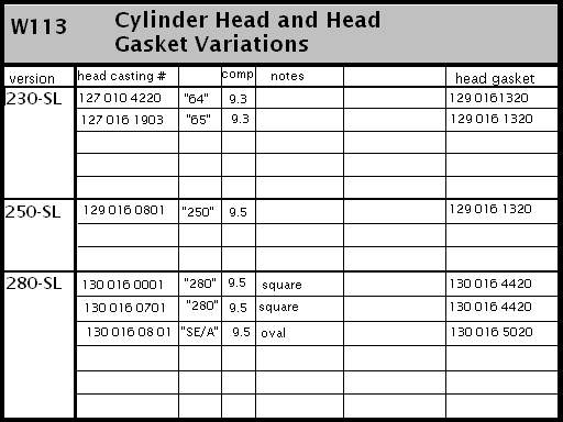

Here is a photo of the early and late version M130 (280-SL) head gaskets for the 9.5 compression heads. They are not interchangable. The late version "oval" combustion chamber head gasket is on the left and the early version "square combustion chamber is on the right. Notice how close the cylinders are together! Do not oveheat these engines.
Download Attachment: Head gaskets M130 engines.JPG
40.58 KB
The engine breaking point for these two types of 280-SL engine was : to engine # 130.983-10-004596 or to eng #130.983-12-007229 for the early "square" chamber cylinder heads. These heads would use the head gasket # 130 016 4420. The later engines with the oval combustion chamber heads would use the head gasket #130 016 5020.
Download Attachment: cylinder head and gasket chart.jpg
40.33 KB
« Last Edit: April 01, 2004, 20:58:14 by ja17 »
