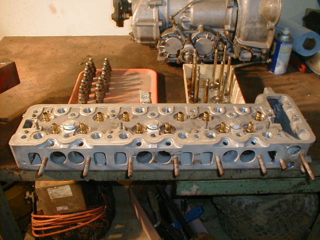

Hello Group,
I am currently assembling a re-conditioned 280-SL cylinder head. I took a lot of photos and thought it may be a good opportunity for a discussion on the subject if anyone has any questions?
Download Attachment: cyl head with parts.JPG
60.25 KB
At this point the bare cylinder head is back from the machine shop with all new valve guides pressed in place and all the valves and valve seats ground. The head was slightly warped and needed to be cut very slightly (.010") to be perfectly flat.

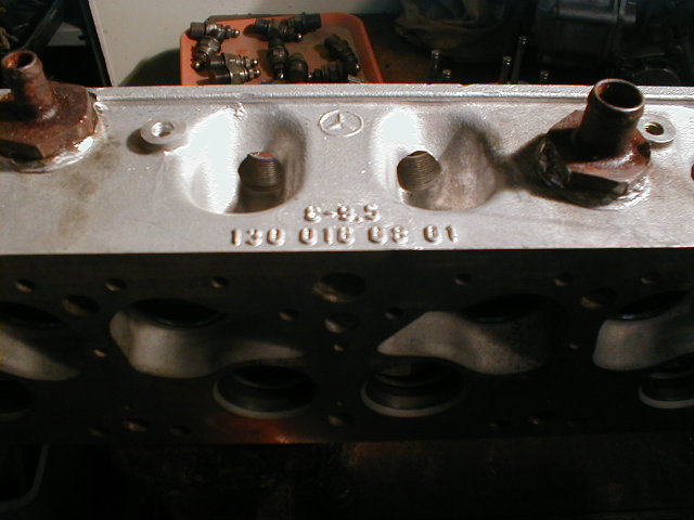

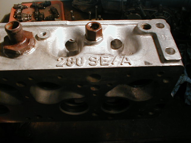

You will need engine number on the engine block to order correct parts. The cylinder head number may be of little use but is cast on the head below the plugs on the right side. The 9.5 is the compression ratio (9.5 to 1).
Download Attachment: cyl head ID.JPG
56.1 KB
Heads after the 230-SL series had a model designation cast into the heads also. Many 250 and 280 series sedans and SLs shared the exact same heads!
Download Attachment: cyl head   ID2.JPG
56.07 KB
More to follow!
« Last Edit: January 14, 2004, 20:09:22 by ja17 »

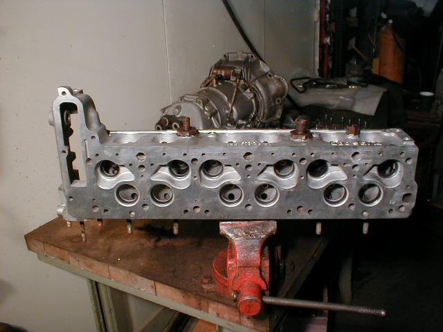

Depending on your ability, background, experience,  tool assortment, and working conditions, you may or may not ever desire to get involved in this kind of procedure yourself. Some of you may just like to be a little more educated on the matter. If you are contemplating reconditioning your head, finding a good qualified machine shop is very important. Very few repair shops do their own machine work. In most cases, after the head is removed an automotive machine shop will do the head dis-assembly, machine work and head re-assembly if desired.  Try to find one familiar and experienced with Mercedes heads. Pressing new valve guides into aluminum heads takes some expertice. Improperly installed guides can come loose after the engine is running again!
I always supply the machine shop with a copy of the correct factory specifications for the machine work and permissable wear limits on parts. Most machine shops will be glad to have you provide them with the correct new parts as needed also.
If desired you can get the head back ready to intstall. In my case I request it back dis-assembled so I can check their work and then re-assemble the valves and springs etc myself. I will try to describe some of the things to watch out for during the process. I have some photos of the basic parts for discussion also. Feel free to jump in. Stay tuned!

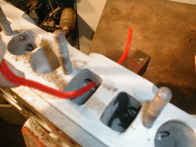

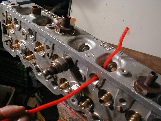

Those are two good points. Removal of the Ball stud bases normally is not needed and sometimes, as Dan mentioned, can lead to gaulding during removal. However in this case this head had that mysterious oil seepage around the spark plugs. It looks like the area is sweating oil. At first glance it looked like it could have been a bad valve cover gasket. A new valve cover gasket did not cure the problem. In these cases oil seeps out through the threaded ball stud holes. Photo for those unfamiliar;
Download Attachment: cyl head ball stud2.JPG
59.04 KB
As you probably know these threaded openings exit right above the spark plugs.
With the exhaust ball stud bases the threaded opening enters the exhaust port so any oil leakage on these would go into the exhaust ports and be burned off in the exhaust(photo).
Download Attachment: cyl head ball stud3.JPG
61.97 KB
My normal routine is only remove these if you see leakage around your spark plugs. If they seem to be gaulding during removal, I try a little heat or leave them alone. When the threads are sealed and the ball studs are torqued back in, the leaks around the spark plugs disappear.
I know what mean on those worn ball studs. They can get a crown worn on top the ball. I have also ground this crown off. It does work well. Sometimes this crown will be so bad that proper valve adjustment is impossible.

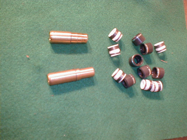

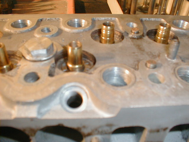

Some typical problems with a cylinder head might be; worn or loose valve guides and valve seals causing, excessive oil consumption. Worn valve stems and burnt valves can contribute to low compression. Warped cylinder heads can be a result of severe overheating.
The valve guides are simply bushings (alloy bronze or copper) which are pressed into the aluminum cylinder head. The valve stems move up and down in these guides. At the top of the guide a synthetic valve seal cups around the guide and the valve stem keeping oil from seeping between the vlave stem and valve guide. Manufacturers have improved the materials used to make these valve guides and seals over the years. The newer silicone bronze valve guides should outlast the original copper and bronze valve guides. The factory has also changed to newer synthetic materials for the exhaust valve seals. Notice the black Viton valve seals for the exhaust guides (originals the white nylon. These were developed to handle the higher temperatures in today's engines.
Download Attachment: cyl head valve guides and seals.JPG
61.81 KB
Download Attachment: cyl head with new guides installed close up.JPG
57.79 KB
Worn valve guides are by far the most common point of wear. Since the exhaust valve guides are subject to much more heat than the intake they tend to wear more rapidly than the intake. As valve guide wear increases, the harder valve stems and valve seats wear also. Eventually the valve and/or seat can wear enough or burn and cause compression loss.

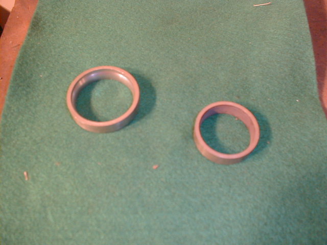

Valve guides can come loose in the head and can end up riding up and down with the valve. This condition will cause severe oil usage and additional damage to the head. The tight hole the valve guide fits into becomes enlaraged and will no longer hold a new standard exhaust guide. Oversize (outside diameter) valve guides are available in several oversizes to correct this condition. If left un-fixed a loose valve guide may eventually cause enough damage to allow the valve to become unhooked and drop into the cylinder causing a lot of damage to the piston and cylinder head.
Ocassionally a valve seat may become damaged or loose and need replacement. This is unusual, but happens at times. The valve seat is the hard steel ring pressed into the head where the valve actually opens and closes. The engine depends on a perfect air tight seal at this seat to maintain compression.
A good automaotive machine shop can prepare the head and replace a damaged valve seat.

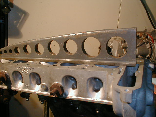

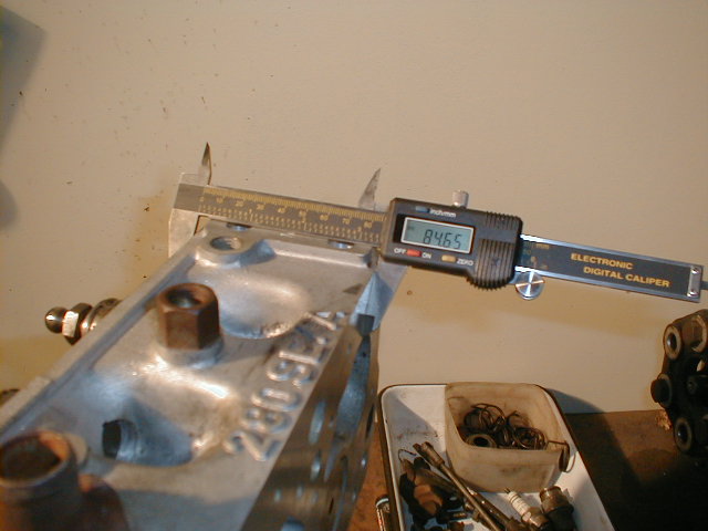

Severe oveheating of the engine is the most common cause of warped heads and blown head gaskets. When an engine is overheated the aluminum cylinder head expands beyound designed limits and actually arches in the center. This allows the head gasket to fail and the aluminum head remains distorted "warped" from the heat even after cool down.
One important item that your machine shop will check when the head is removed is the "flatness" of the cylinder head. A head warped more than a couple of thousanths of an inch must be trued-up "milled".
In the old days when cylinder heads were cheap, it was common practice to automatically mill heads before any valve job, whether the head was warped or not. These days new heads are thousands of dollars to replace. You can only cut  one millimeter off of these heads before they are scrap. With this in mind milling the head should only be done when needed. This information should be conveyed to the machine shop so your head is not milled unnecessarily.
The heighth of your  cylinder head must be measured first to see if it is the stock 85mm. 84 mm is the minimum. It will have to be measured in several areas along the length of the head.
Download Attachment: Heigth measurement 1.JPG
54.31 KB
Next cylinder head is checked for warpage using a machinist straight edge or similar.
Download Attachment: check for warpage.JPG

Feeler guages can be inserted in any gap between the head and the straight edge to determine the amount of warpage. Hopefully if your head is warped you will have enough material to mill it flat and stay within the 84mm minimum heighth. Some machine shops offer a head straightening service these days, which can re-flatten the heads somewhat before milling.
Now consider what happens when you mill a head flat, which has been  warped or arched in the center. Most of the head material is removed from the ends! Often times a used cylinder head which has been milled is much shorter at the ends than in the center! Since the combustion chambers are in the head, the compression on the outer cylinders becomes higher! The center cylinders may remain normal since little head material is removed at the center. Another bad effect of head milling is that the timing chain becomes longer as the head becomes shorter. If one milimeter is removed from the head during milling, the timing chain tensioner must take up an additional 2mm of chain, shortening the usable life of the timing chain. In severe cases the warped top deck of the cylinder head may cause camshaft bearing problems. Mill only when needed, or as Dan has said, you will have an expensive boat anchor on your hands.
