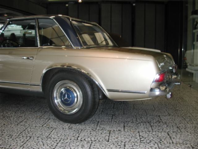

The branding irons are made by Hazet and were still listed in their 2002 catalog.
Ben,
I think your summary is quite aaccurate!!

Klaus,
Your 280SL's hub caps would cover the whole wheel (rim), so it makes no sense to paint the wheel (rim) body color.  Therefor I would assume your wheels (rims) are black.
My 230SL, which is very original still, has the wheels (rims) painted gray just like the body.  The small hub caps are painted grey-white just like the hard top is.  Between the small painted hub cap and the chrome beauty ring there is some painted wheel visible.
You can see this technique in the graphic posted by NAJ and here:
