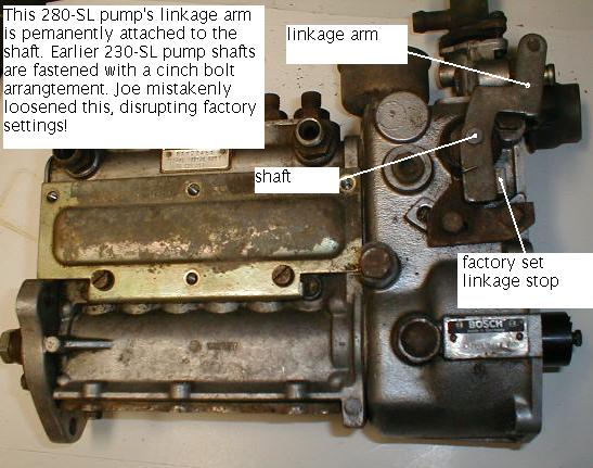

Here is some more information on your problem; (click on the enlarge
button to inhance images)
Download Attachment: pump linkage arm ill.JPG
54.63 KB
Download Attachment: Internal pump ill.JPG
66.36 KB
« Last Edit: December 02, 2003, 23:58:29 by ja17 »

Well, Joe, you read my mind! I was wondering just what is going on inside the injection pump when the accelerator is pressed. Just what is happening when the lever is mounted to the shaft in a different place? Does this alter the time the fuel is sent to each cylinder?
Do you think it would be possible to set this back up using the exhaust analyzer, viz., setting the axle to the shaft so as to have the CO in spec at the tailpipe at idle?
I'm not sure how I would turn the axle with the lever on. Not much room to grab ahold of it.
If I were to have this recalibrated, who does that, and what do I have to send?
This looks like an opportunity to learn even more about how this car works!
Appreciate the advice, for sure.

GOOD GOD DON'T DO IT. DON'T START YOUR CAR WITH THAT THING IN A DIFFERENT POSITION !!!!!!!!
  Last time I had a customer do what you did it bent something inside of the pump. Sorry, but you will need to send it to a Bosch rebuild centre for calibration. This shouldn't be all that much really if everything was working OK before this happened.
