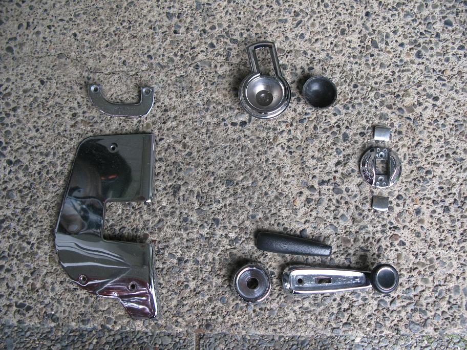

Heres a Picture. I think this is all I took off to remove the panel, beside the screws holding it to the door. One is located under the armrest, atleast on my 230. Picture should tell you where to find the screws
Download Attachment: IMG_0576.JPG

Thank you so much - the pictures and descriptions actually do help alot.  Did you recall, did you have to remove the chrome strip at the top of the panel also?

The chrome strip at the top of the door panel comes off with the door panel.  After you have removed the door lock screws, window crank, chrome as shown, and possibly a screw under the arm rest (mine does not have this screw), and the grab handle if your door has a grab handle (screws under chrome covers for grab handle) then you can lift up on the door panel at the edge closest to the rear of the car and it will come up (slowly, it's detaching from clips along the top edge).   Note that somewhere I read that you need to remove the two screws going upwards that hold the armrest and are impossible to get to.  That is not the case -- those don't hold the door panel in and those are for removing the arm rest which must be done with the door panel out of the car after removing the door pocket from behind the panel.
