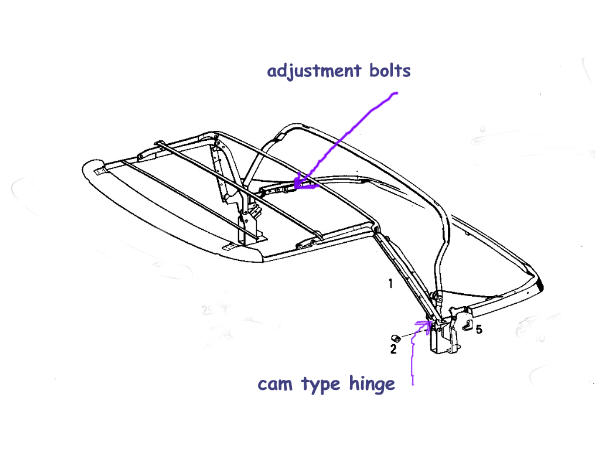

An answer to your first question may involve lubrication of a cam type hinge noted on the enclosed drawing.  A cam type hi8nge is located on both sides.  If it is the problem you can mark the location of the mounting plate inside the storage area and remove the two bolts with a 13mm socket wrench.  You can then lift that side of the soft top up for access to the hinge.  You can try to lubricate it as is or take it apart for cleaning etc.  Remember you have the other side as a guide to use when putting it back together.
There are four areas that I know of for adjusting the top.  Two of them are discussed above.  You have about 1/2" of movement available front to back on each side.  Movement here will affect how the front pins contact the windshield so be mindful of these connections when adjustmenting.  The rear hoop has two additional adjustemnt locations.  They are on the inside of the hoop near the hinge and are shown on the drawing attached.  If the rear latch favors one side of the hole over the other you can adjust these locations to bring the rear pin in center alignment with the hole.
Good luck!
Download Attachment: softtop.jpg
