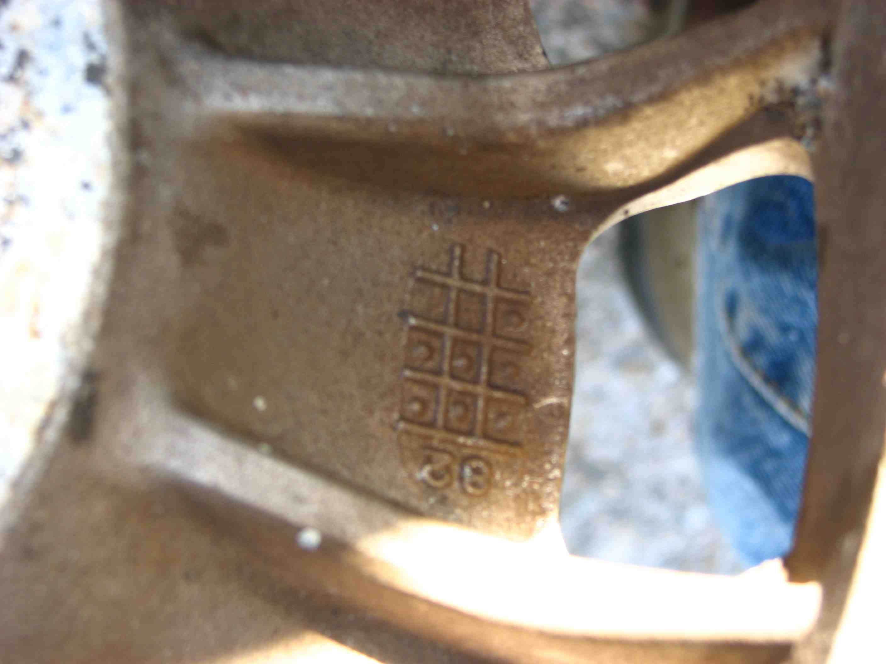

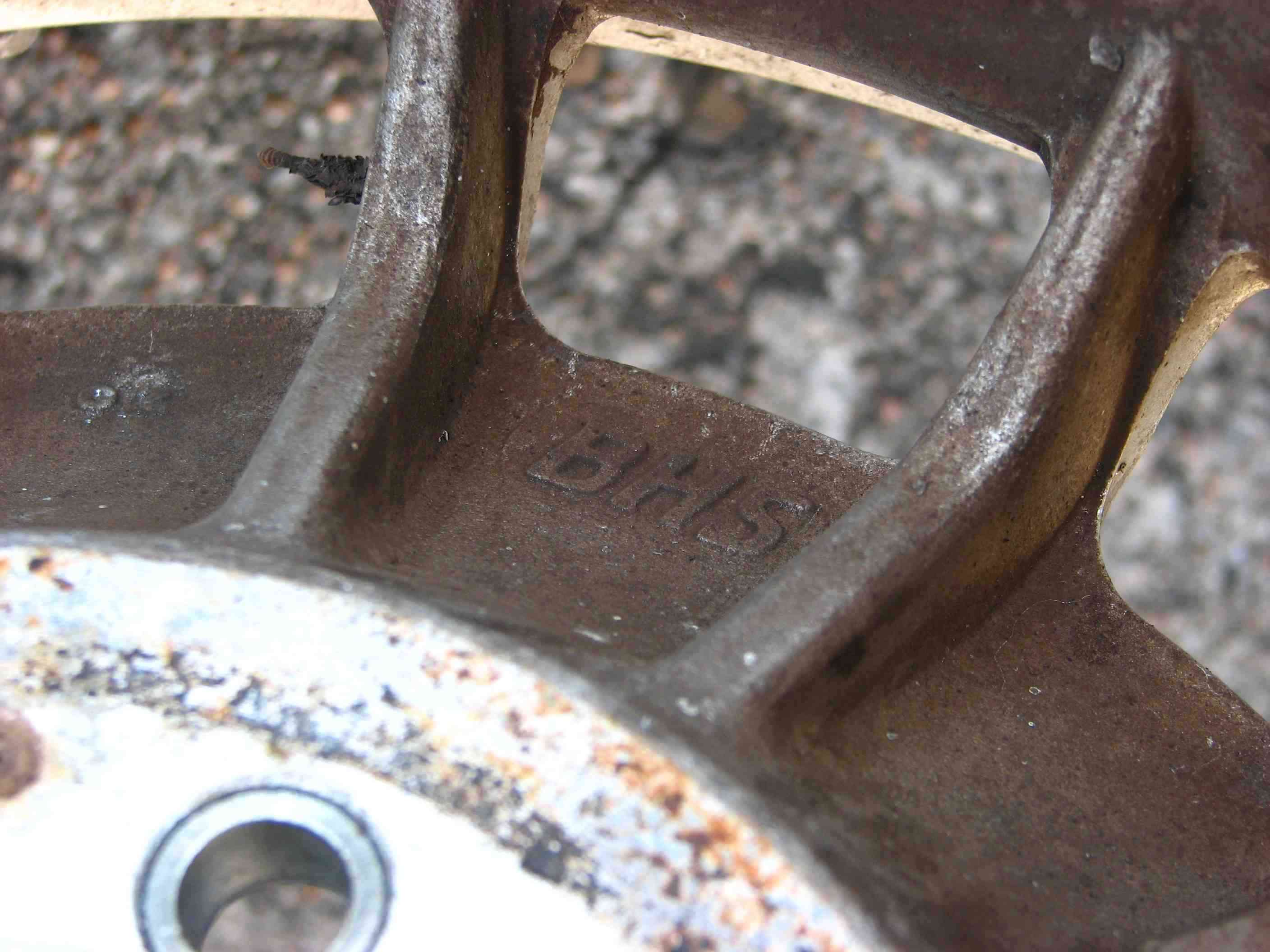

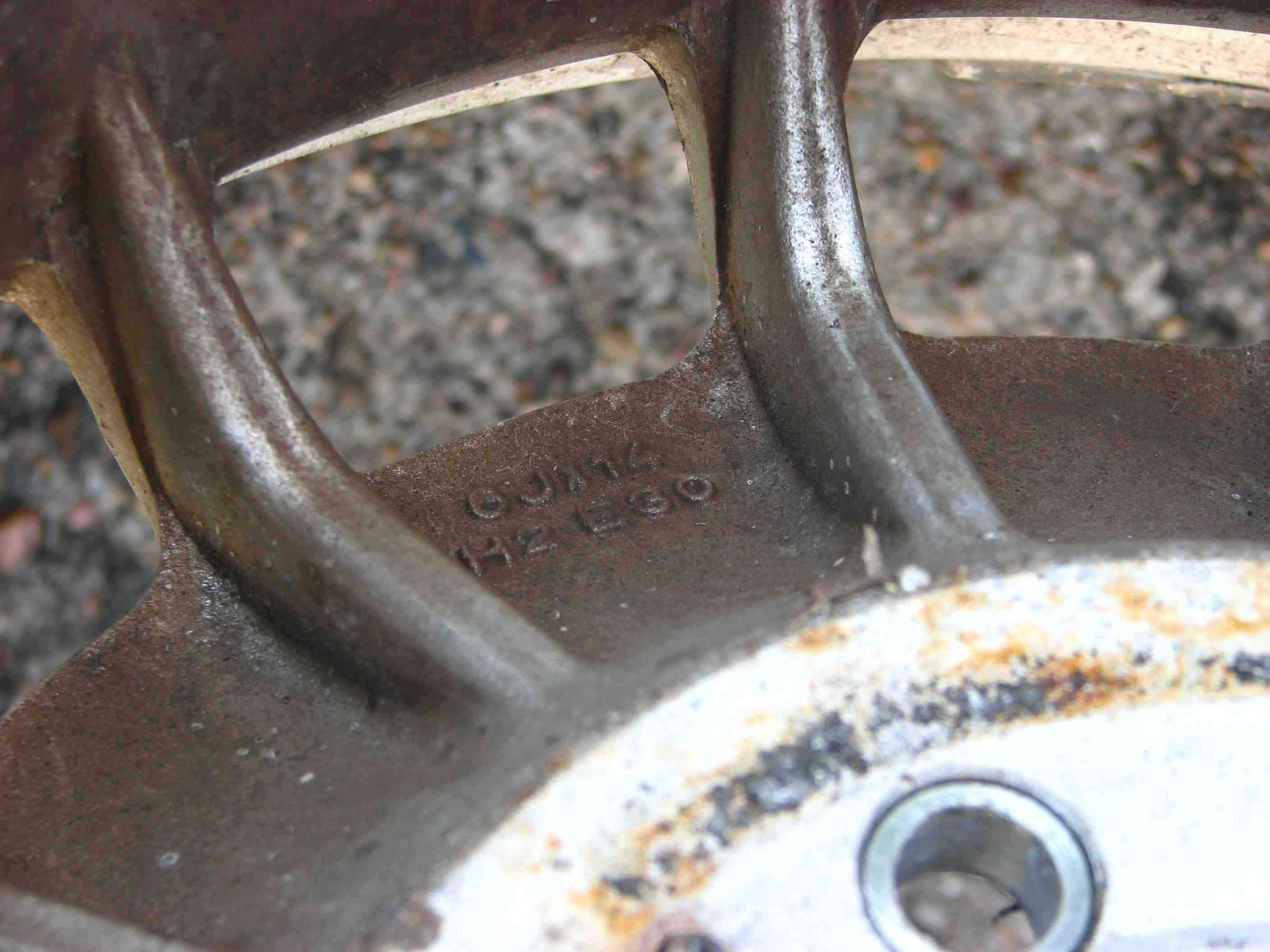

Can anyone confirm (or deny) that this is an original Mercedes bundt wheel? It looks like it has the insert in the lug bolt holes....

You should also see a part number cast into the back of the rim.
Have a look at the technical manual: http://www.sl113.org/wiki/pmwiki.php?n=WheelsTires.Alloys
I don't recognise the codes on your wheels (BHS ?) as of one of the 3rd party manufacturers I have listed (Ronal, Centra, ATS) but then I did not research those in detail.
6JX14 H2 E30 are just sizing codes (E30 is Einpresstiefe, see http://www.sl113.org/wiki/pmwiki.php?n=WheelsTires.Start).

I can't seem to find any other part numbers on the entire rim. They would seem to be aftermarket, since there was no 10-digit MB part number anywhere. Just thought I'd ask in case someone here knew of this manufacturer "BHS".

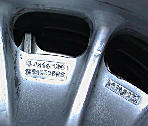

There are two sets of markings directly across from each other on the 1264001902 Fuchs Bundt wheel set that someday I'll get powder coated !!!
Wheel size, Merc part number and VIN?
Wheel offset
