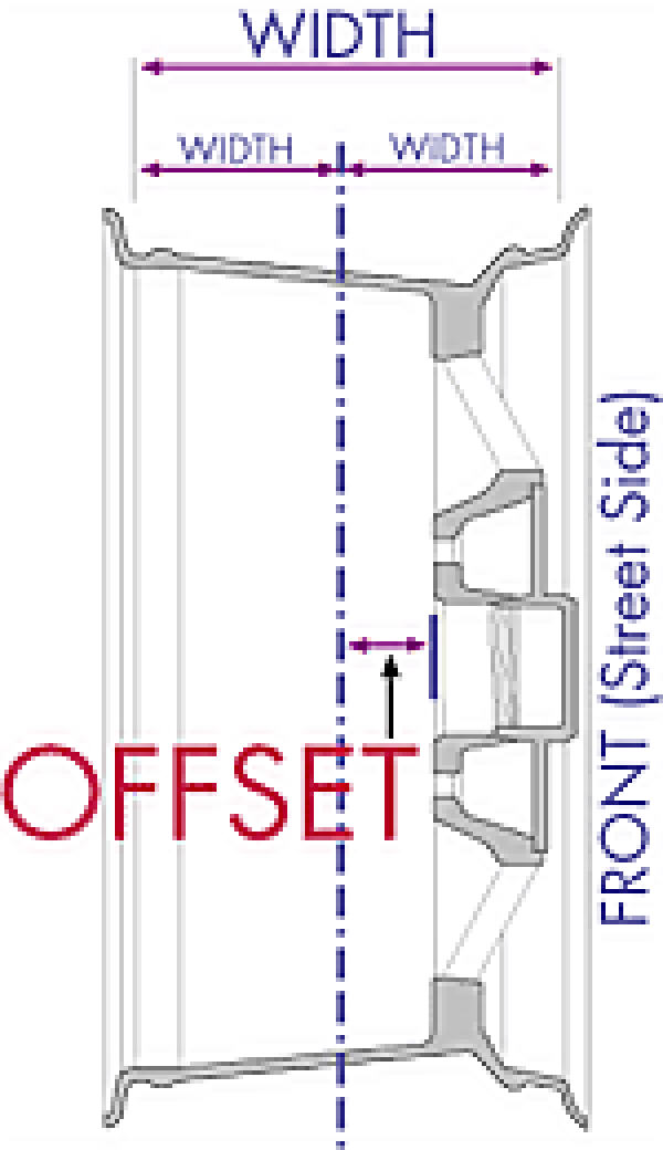

When considering different rims and tires we must consider many factors.  Width considerations involve the potential impact of changing from 6" to 7" rims and any offset changes.  A 1" rim width increase adds 12.7mm the the inside and outside rim width when measured from the centerline.  I believe out the SL standard 14x6 rim has a 30mm offset.  If a new rim has the same offset 1/2 the increase will be added to the inside and outside of the rim when compared to stock.  I think the offset of the 15x7 Barock wheel is 23mm.  This rim will add 20mm or about 3/4" to the outside and the inside will be 6mm or 1/4" less to the inside with when compared to the stock wheel.
Here is a pic of where to measure the offset.
Download Attachment: offset.jpg
61.51 KB
Here is a website that sells spacers to compensate for offset differences.
http://www.optionimports.com/h-r-spacer-benz.html
This is nice and tidy but doesn't answer Peter's question.  I suppose one way to figure this out is to install new tires and rims.  An alternate is to use a mockup of the rim including correct offset with a tire sample.
I hope someone can assist with some actual field data.

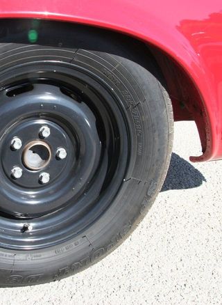

This any good? Its a 6.5x14 out of a W116. In my view, they look a lot nicer than the 6x14 wheels (from W123s)
I had them on my 230SL. Excuse the mess, picture taken just after it came out of the paint oven.
Download Attachment: Alloy6x14.jpg
68.55 KB

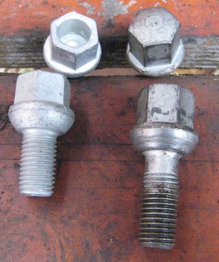

Alloy wheel lug bolt:
Overall 50mm
Shank: 28mm
Steel wheel bolt
Overall 40mm
Shank 20mm

« Reply #43 on: November 10, 2007, 08:20:03 »
Originally posted by naj
Can you confirm the lug bolt length?
12MM x 1.5 size
63MM overall length???
39MM thread length ????
Overall 50mm
Shank: 28mm
Steel wheel bolt
Overall 40mm
Shank 20mm
Naj
Much thanks.
Shorter then I thought !!!
ED A.

Download Attachment: WhlBlt.jpg
36.82 KB
