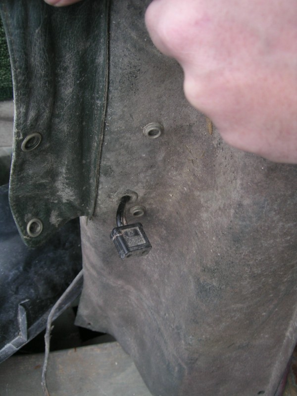

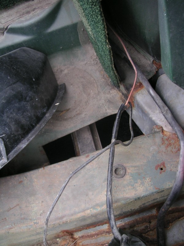

What are these wires for? need to cut to remove
« on: February 09, 2008, 13:00:30 »
This is behind the drivers seat the vinyl piece that the seat belt 3rd point attaches to. The wires and plug end go through the vinyl.  The wires split one coming out the vinyl with the plug the other going to where the drivers seat would be.  I need to remove the vinyl piece to dye, but I don't what to cut these wires until I know what they do.  The end plug , even with the grommet out, won't fit through the hole in the vinyl.

Baron,
I might very well be wrong--but this might be the power connection for the rear-window defogger on the hard top.  Do you have a hard top?  If so, check and see, you might have a pigtail wire coming down for that.

Re: What are these wires for? need to cut to remove
« Reply #2 on: February 09, 2008, 16:39:48 »
The flying Hood reminded me of story told to me by Ray Paul (parts dealer)...
Seems that a Pagoda was driving down the highway when the hard top flew off! Top went sailing up and back. The surprised driver stopped along the shoulder of the road then looked back to see if anyone was hurt and to see what happened to the top.
Small miracle, the top landed on the highway, correct side down. Nothing hit by the top, and nothing hit the top...minor damage to the top, not even the glass broke.
Moral of the story: make sure the top is LOCKED into place by both front pins...the tiny middle pins will not stop a flyaway top.
Richard M
P.S.  I once had my soft top fly back but only to the first frame rib. Now I always double tighten the front pins.
P.P.S. A car that has a rear window heater will have a switch located just behind the ashtray.
« Reply #3 on: February 09, 2008, 19:57:39 »
Perhaps you can disassemble the connector? These connectors either have a tiny bolt holding them together, or is the later snap-together type. Once apart, you might be able to slide out each wire one at a time (with the soldered end still attached).
Hope this helps.
« Reply #4 on: February 09, 2008, 20:16:56 »
Hardtop heater wire that is it! It matches pigtail on hardtop Thanks!
