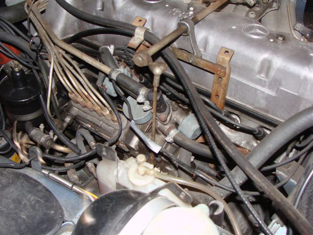

The duct tape is on the cable, which is middle of the picture, bisecting the vertical rod coming up from the fuel injection pump.
The unit sits just behind the 2nd cylinder and has two cables into it - one clearly related to the ignition system. This cable attaches (barely) to the copper/rust coloured connection just visible by the clips holding the HT leads in place alongside the top of the 2nd cylinder
Anyone able to shed any light?

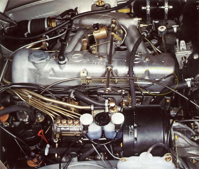

I think Matt was right. It is the capillary tube for the temp sensor.
Its incorrectly routed I believe. It should run along with the plug HT leads. Also, the right rusty upright should have a cable clip similar to the one on the left upright and it supports the HT leads and the capillary.
The capillary is quite fragile. So do not mess with it. Instead, disconnect the pipes and throttle rod that is in the way to move it back to the upright. Cable clip Part # A115 159 0140
