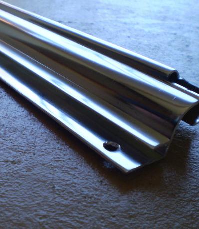

I am trying to remove my carpets to get some rust repairs done and I'm not sure how to remove the threshold trim that holds down the top edge of the carpet just inside the door.  Are there hidden screws or does it pry out?  Thanks in advance!

Hey Pete. I am not 100 percent sure but I seem to recall that there are screws inside the groove that holds down the carpet. In my case, the carpet was wedged in and sort of crimped into this groove. Good luck.

I have the trim here and there are counter sunk screw holes  on the carpet side that holds it down but the carpetshould just slip into the groove.  see photo
Download Attachment: cut.JPG

Thanks guys!  Just what I needed to know.  My trim is pretty dinged up, but it's very expensive to replace.
