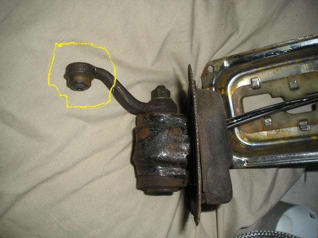

Does anyone have a photograph or a diagram of what this (circled) assembly should look like when attached to the shaft connecting it to the tranny and what hardware is involved? It is the hardware which connects the bottom of the shift lever (automatic) with the shaft which goes to the tranny/neutral switch. Looks like there is a plastic bushing surrounding an encapsulated metal faster ?? Any part #s would also be helpful...Thanks

now with pic

My catalog 10202, which is for the 250SL and 280SL shows the part as 113 260 04 39 (lever). However, if you look at the SLS site:
you will find two versions. Clearly the 230SL (or early) version is somewhat different.
You may contact SLS for availability. Also, their diagram is fairly clear as to how it is assembled.  Cheers.

Find all the info you need here:
http://sl113.org/forums/index.php?topic=3717
