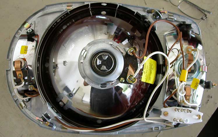

Hello All!
I just installed a set of new Euro headlights that I purchased from Adsit.  I followed the procedure below (from an earlier post...  thank you!).  Procedure worked great !!! The lights, and...  fog lights light up nicely :) !
 :?:  :?: My question is...  has anyone been able to figure out how to add to this procedure and make the front side marker lights blink with the blinkers ???

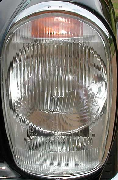

Bob, did you get the flat lens or the bubble type?
Re: Euro Headlights
« Reply #2 on: September 14, 2007, 19:14:24 »
Hello Hauser!
I believe these are the bubble ones...
I will take pics of the front of my car tomorrow, but in the mean time, here are a few pics of the light fixtures...
Download Attachment: euro1a.jpg
39.13 KB
Download Attachment: euro1b.jpg
62.7 KB
Download Attachment: euro2a.jpg
50.82 KB

Do you have any tooling marks on the lenses?  These marks look like tiny cracks in the glass.
You may want to consider upgrading the bulbs to halogens.

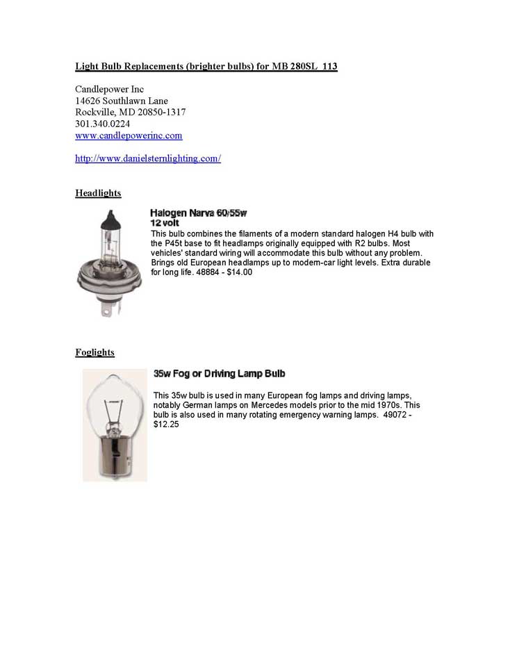

I also upgraded all light bulbs with brighter bulbs, recommended by Daniel Stern. (I will post bulb chart later)
Bruce, thanks.  What I will do to get the side markers to flash with the front blinkers is use the "ground wire" of each side marker light and connect this to each respective blinker wire (black/green=right; black/white=left).

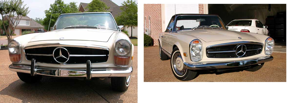

Here is a before and after picture (USA to Euro lights).
Download Attachment: euro_usa.jpg
74.79 KB
Re: Euro Headlights
« Reply #14 on: September 15, 2007, 21:02:48 »
I am a little biased but I like the new look better! Makes the car look more German to me -- like its ready to take on the Romantische Strasse!

I see you also either removed the bumper guards or changed the bumper.  I too prefer the look as you now have it.  If you changed the bumpers, are they OEM or aftermarket?  Any issues with fit?  I spoke with you about your car in Ohio.  Your car looks very nice.

Thanks James & Frank,
I went with aftermarket bumpers w/o the guards.  Went the cheaper route and packed my originals away, with the USA lights.  The next owner can return car to original if desired very easily. What is nice about the wiring change in my original post is that is does not require any cutting.  Just plugging in...  So, lights can be quickly returned to it's original delivered state.
I purchased the aftermarkets from the ImportBaron. They seem to be pretty good, in general, but not perfect.  The issue that I have had with them is that they required me to use shims to get them to line up correctly.  With my OE bumbers, I didnt need any shims.  They also required new non metric bolts. (Note: The ImportBaron does not respond to emails! He likes to use the telephone).
For now, the aftermarkets work for me.  In the future, I may get my OE bumpers rechromed and have the guard hole removed.  I agree, I really prefer this new look over the USA look, but it truly personal preference.

Here are the brighter bulbs I purchased from Daniel Stern for the Euro lights & rear lights:
Download Attachment: LightBulb1.jpg
41 KB
Download Attachment: LightBulb2.jpg
44.19 KB
« Last Edit: September 18, 2007, 20:10:05 by bpossel »

Wasn't there an original 'flat' glass euro headlight that had halogen bulbs??  I know that there was both a rounded and a flatter glass euro headlight.....
Regards -- Roger
