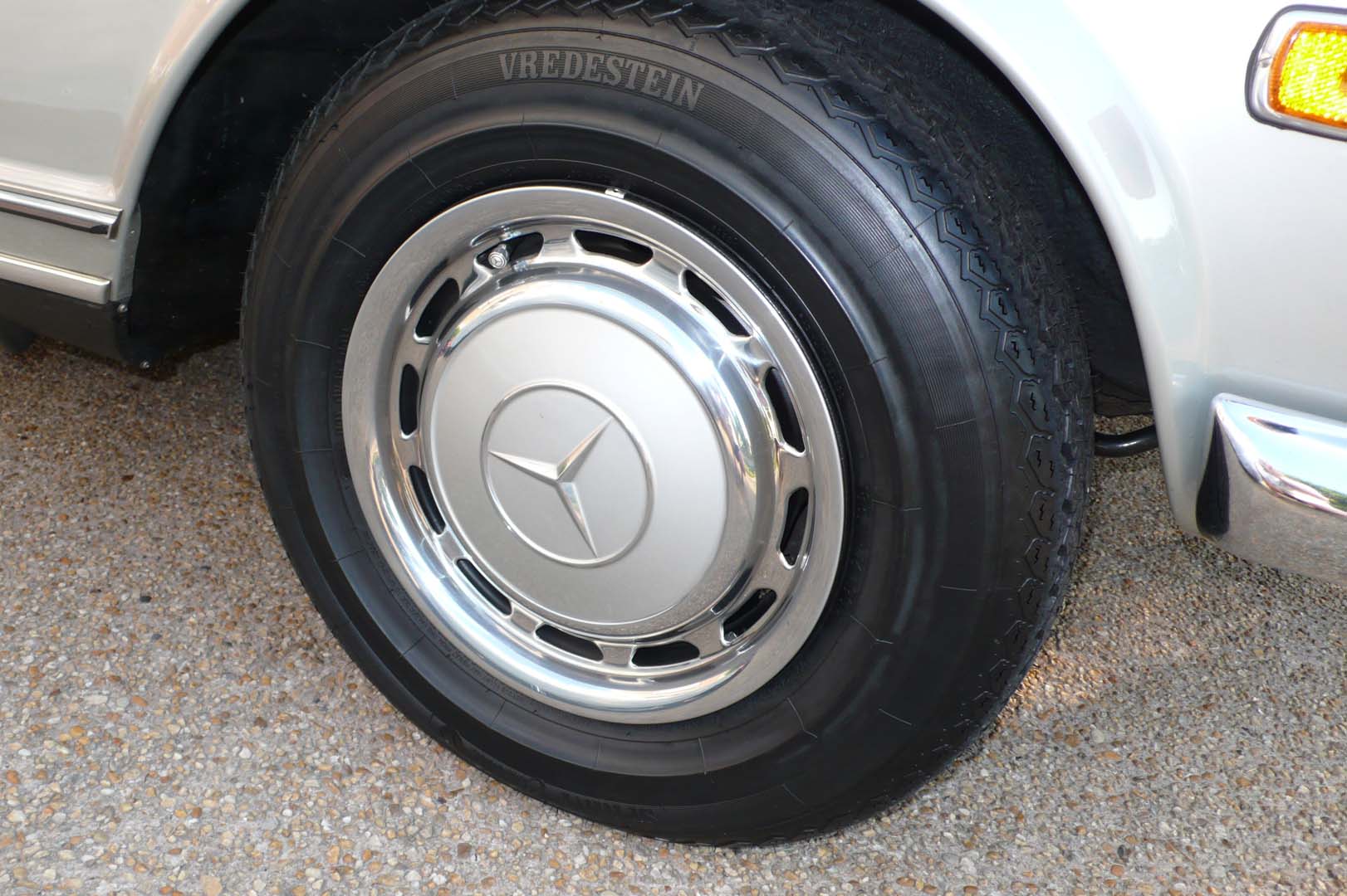

Specs on Vredestein tires.
The info:
Code: [Select]
Vredestein Sprint Classic @ $135.00 each
Tire size - 186 HR 15
Section width - 185.17 mm (7.29")
Section height - 149.08 mm (5.83")
Overall diameter - 651.51 mm (25.65")
Aspect ratio - .80
Load index - 90 = 1323 lbs
Speed rating - H = 130 mph (210 Km/h)
approved wheel width - 114.3 - 152.4 mm (4.5 - 6")
The contact for these tires is Josh Spangler at 1 (800) 576-1009 ext 775 (e-mail is jspangler@tirefactory.net)  also you can see the ad at www.tiresbyweb.com

I've been uising Vredestein 185/14 tires for about three years and they really ride great and look good.  I would reccoment them.  I don't think they are made in a whitewall in that size however.

Took my Vredesteins on the Interstate last weekend for a 300 mile round trip.  At 65 mph it was a GREAT ride.  Like driving a "new" car.  Mind you I also have PS, new brakes/pads etc, and shocks.  A really great handling tire that conforms to the car's specs.

Just installed Vredesteins on  5.5" w123 alluminum wheels. I can honestly say that in the 8 years I've had the car this is the best single improvement I have made. The car looks and feels terrifc, nimble and just 'feels right.' I strugled with the choice, 205s vs. 195, vs 185. Our minds are conditioned to think that wider is probably better, but in these cars it's not the case. The car sits higher, (I had 195 / 70 Bridgestones before) and the wider diameter fills the wheel well the way it was designed. Since I do not particularly care for white walls, these are the perfect choice. The wheels save about 20 lbs. per wheel and take the 14" hubcaps, so they are not noticeable. Make sure they are properly balanced and your front end is properly alligned.  They are significantly cheaper than the Phoenix, but not cheap... but worth every penny.
