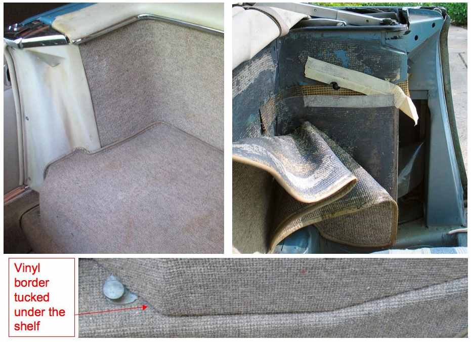

Steve,
on my (late) 230SL the carpet wraps around much further than the one on the eBay car.  It apears that the owner of that car put  a speaker into the side panel. The attached picture shows what's behind the carpet under the soft top release on my car.
My original carpet also has the complete vinyl border and it was tucked under the wood box just like Dave's.

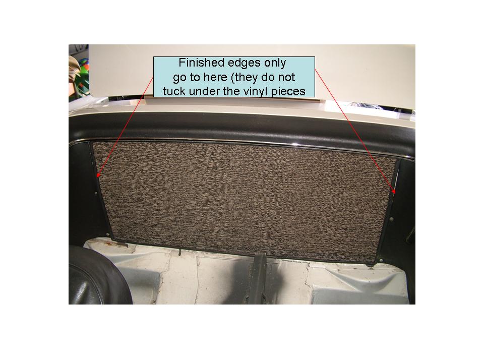

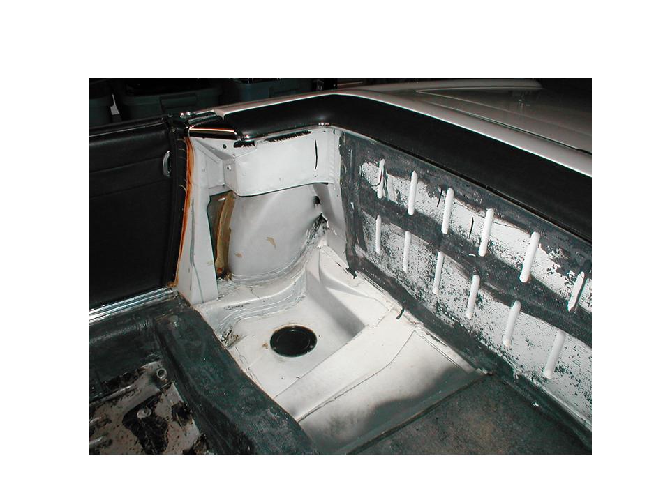

Alfred:
Thanks for the ppt tip.  I've loaded the picture here, hopefully it gives some perspective of the rear area.  I've removed the side panels and the metal is clean and white (no evidence of carpeting ever having been glued under the panel.) I've also posted a picture of the rear area with the panel and carpet removed, you can see where the carpet gluing ends where the panel begins.  Oh, this is a squareweave carpet.
Thanks for the comments.
Steve
