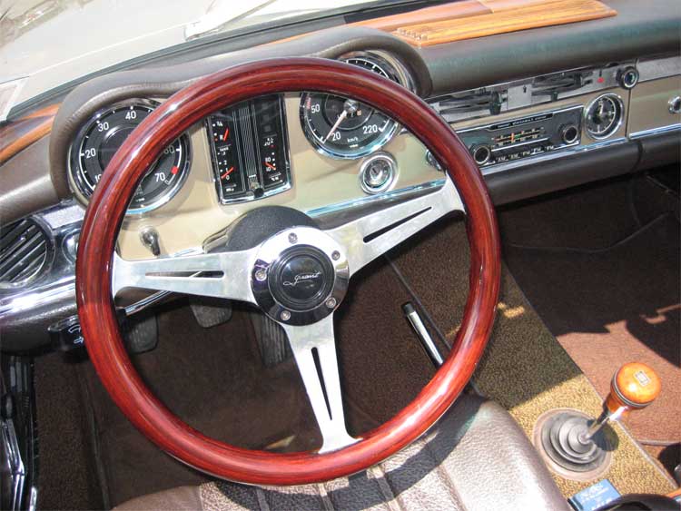

Both my Pagodas had wood wheels...one was a Nardi, the other is a Grant. These wheels are available in sizes smaller than the original wheel.
With power steering, wheel size is not a real issue. Some wheels can block part of the view of the instruments depending on seat adjustment and the height of the driver. A slight tilt of the head is usually all that is needed.
Here is the Grant wheel.
