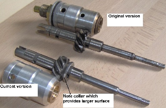

Originally posted by joe alexander
The Verticle timing gear is also refered to as the "drivesahft for the oil pump and tachometer" in the BBB. The specified clearance for endplay is very small (0.1mm - 0.25mm) or (0.004" to 0.010").
The thrust piece or "aluiminum/bronze bushing" wears and allows this verticle timing gear to move upward during engine operation.
I am replacing these cross drive shafts on my car. You buy them as a pair, part No 130 050 0406. It seems M-B have identified the wear problem described by several of you in this thread, and the vertical shaft has been re-designed. See attached photo. With the new shafts you also need a new Tacho drive bushing (thrust piece). Part number for the new bushing is A615 180 0344.
On the re-designed parts, the contact (wear) area is much larger, and is lubricated more effectively.
Download Attachment: Drive_shaftM129_2.jpg
57.66 KB
/Hans in Stockholm
« Last Edit: March 29, 2005, 23:09:03 by mbzse »

  • Posts: 7519
Re: play at tach drive ?????
« Reply #31 on: March 31, 2005, 04:30:11 »
Hans,
Thanks for the new information, this is an important subject. I susupect the cost on these expensive  new gear sets has risen also?
