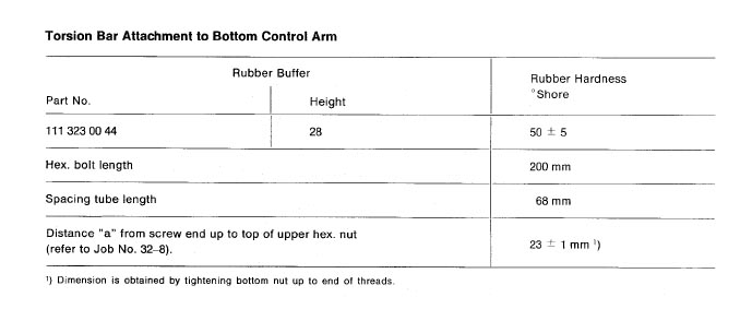

 :) Update!
I found the spec in the BBB (32-0/15).
See attached pic. Jim, you are correct 23 +- 1mm.
