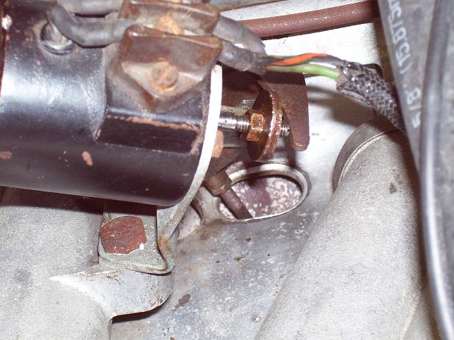

I have perused the threads pertaining to the CSS and found alot dealing with it not working. My extends all of the time. As soon as I start the car the rod extends outward. Could the switches on the transmission be the culprit? Also, I am not able to adjust it at all. It seems to be frozen on the shaft. I tried to turn the nut while holding the shaft with a small screwdriver without any success. I soaked the threads with oil and even (ouch) tried to turn it using a pair of small vise grips on the shaft, no luck. I do not know if the nut and the knurled wheel on it are separate or one piece. Also is the shaft spring loaded somehow? The shaft slides in and out from the solenoid without resistance of any kind. I have a  1966 230SL.

Hi Rolf. I am not sure I can help much. I do notice your adjustment nut and stopper disc (?) are way farther down the shaft than mine. In my case, the disc is almost to the end on the screw. I realize you can't seem to move it -- just an observation. Good luck.
PS I think the nut and disc are one.

Rolf. I just looked at mine. The nut & disc on mine are one but there is a second "lock" nut that tightens up next to it. On your picture, it almost appears that the disc and nut are separate...
Also,for what its worth my inside most wire to the CSS is brown and green striped. the other appears black.

Thank you all for the replies. As soon as I can, I'll check the wiring and hopefully find out what is wrong. As to the adjustment, I can't seem to move it either up or down the threaded shaft. I have tried holding the disk and turning the nut but the shaft rotates along with the nut. I tried a screwdriver in the slot at the end of the shaft and it seems the nut is frozen on the shaft? Any suggestions?
