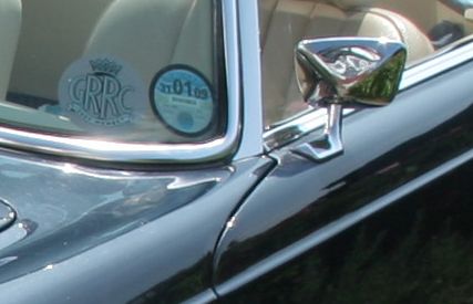

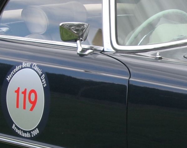

Question about a right side mirror mounted on a 280 SL.
The neck of the right side mirror is longer and curves more sharply toward the window than the original mirror on the left side.
The long neck mirror cannot be adjusted for rear view even though mounted in the same relative position as the left side mirror. The right side neck curves the mirror into the window.
Is this right side mirror from another car? or what is the problem here?
Can the problem be fixed by getting a correct right side mirror? What is the part number of a correct mirror? Is the part number stamped on the mirror base?
Here's a photo of the long curved neck
Download Attachment: Mirror_Rightside.jpg
56.43 KB
Here's a photo of the original left side mirror for comparison. Even though the angle of the photos are not the same, you can probably see that the neck of the left mirror is short and straight.
Download Attachment: Mirror_Leftside.jpg
54.98 KB

  The bottom picture appears to be a right side also??  At any rate my right side mirror is the same shape arm length as the left (maybe a mirror image?). The mirror in your first picture does not appear to be for a 113.  Sorry, no part # appears on my mirror.

Both of the pictures look like a right side mirror to me...

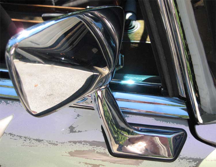

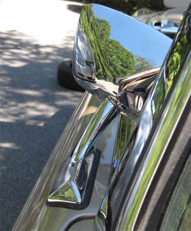

My Mirrors (if it helps);
Right:
Left:

Umm, that mirror on your passenger door is from a sedan model.  The curve of the door top is steeper hence the curve, whilst the SL is a flatter top and a straight line for the mirror neck.
