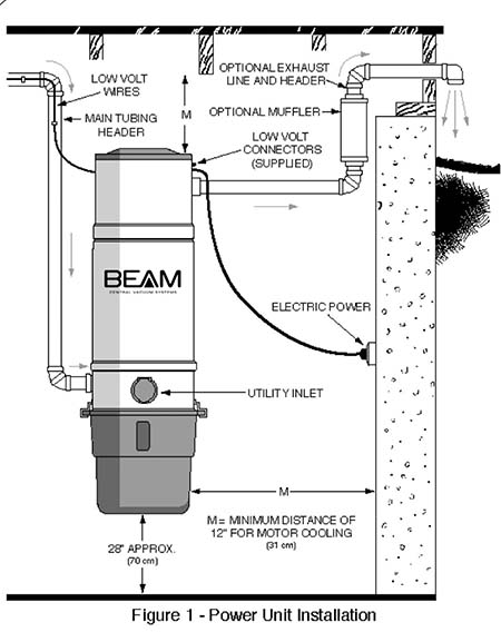

I believe one culprit to my dust accumulation problem is the central vac system we have.  It keeps our indoor air cleaner but I'm afraid the tiny particles are dumped into the garage.  I'll see if Beam the manufacturer has some sort of filter for the outlet.

Based on their factory diagrams, the Beam central vac systems operate much like my car wash vacs, except you have or should have, an exhaust that goes OUTSIDE.  If properly installed, the unit should offer little or no air or dust movement around the vac unit itself.
That being said, I know that my garage is incredibly dusty and dirty.  Probably due to the trees in my neighborhood amongst other things.  Compare and contrast to thelews who has a garage cleaner than my house, and doesn't need any water (just a damp rag!) to clean his cars!
Feel around your vac; if you feel any air motion when on, it might be blowing dust around.  Also try the Static Guard, it might help.

The Beam wasn't in the picture when the house was on the drawing board so it didn't get vented to the outside. :(

Hauser, unless you have an older unit, it shouldn't be a big deal to vent it to the outside; all current models have the option.  There's generally an outlet (probably uses 1.5" or 2" PVC) and all you need to do is vent it through a wall.  Even if they didn't locate it in an optimal location (like ON an outside garage wall) you can still run the pipe where you need to.  Unless there's something very peculiar about your house; the unit; or its location, shame on the installer.  Most homes around here have had these retrofitted and they are all vented to the outside with PVC.
Even if your home is made of concrete, a $60 rotary hammer from Harbor Freight will have a hole in the wall pretty quickly.  If you can work on your Pagoda, you can do this.
Who wants that air motion, dust and germs anyway blowing around their garage?  Pagoda or no Pagoda; that's why they have the vent.
