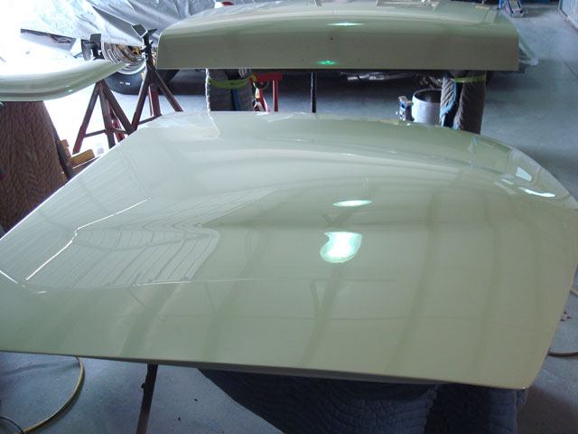

Here is a pic of the hood, taken yesterday.  Picture is a bit dark, but hood is nice and shiny!  With some luck, they will actually start putting the base coat on next week....  i hope!

My guess is you have nothing to worry about.  One day I'll be saying, "Gee, I'd like my car to look like Bob Possel's" instead of the other way around.  And, that day is fast approaching!
