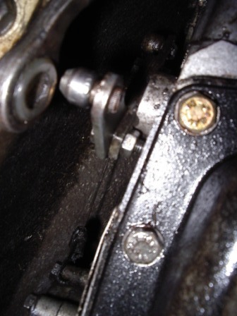

I got my wife's 230SL out for the first time in months the other day. It started up fine, I pulled out of the garage to let it warm up and then put it in reverse to make the turn out of the parking area. To my horror (it's my wife's baby), it went forward instead of back. I shut it off and checked underneath. This is what I found:
Download Attachment: IMGP2426a.JPG
61.32 KB
It's a bit obvious what the problem is. What I can't figure out is how to get the two parts back together again. My wife thinks it may need a plastic bushing. She has a couple of spare ones (part #A 000 462 02 32)that she's had since 1981, but I can't see how they could work. I really just need to know if this is something that can be fixed at home with what I have in my small toolbox, or if we're going to have to take it to a professional. Any advice would be greatly appreciated.

« Reply #1 on: July 30, 2007, 05:41:47 »
Originally posted by marion
.../...What I can't figure out is how to get the two parts back together again. My wife thinks it may need a plastic bushing.../..
Find all the info you need here:
http://sl113.org/forums/index.php?topic=3717
/Hans in Sweden

« Reply #2 on: July 31, 2007, 11:30:13 »
You should consider getting new bushings, I installed new/old shift bushings form ca. 1981 and they disintrgrated within a week of installing them.

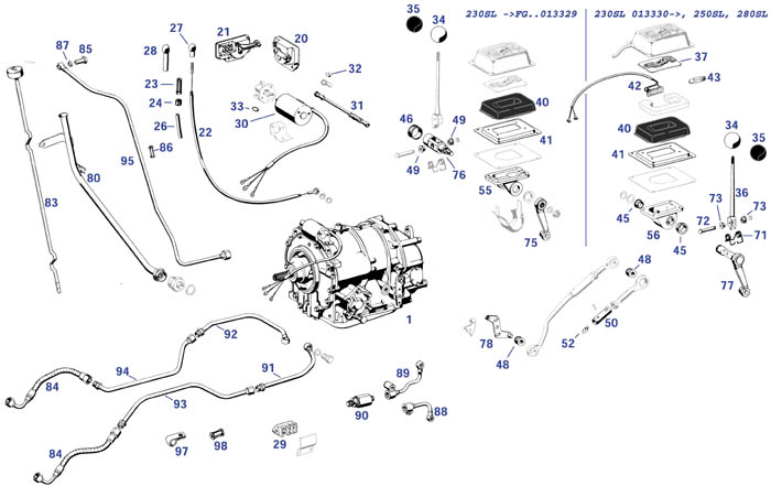

« Reply #3 on: August 01, 2007, 05:09:46 »
Thanks for the help guys. Still a bit confused, though. The part that has become disconnected is the end of the rod that is attached to the part labeled '78'on the diagram below.The end that connects to the shift lever is still on. Looking at the end that has come off, I can see what appears to be a BLACK bushing or insert. Does the white bushing fit inside this? Or is the black one the original bushing, and it is just worn to the extent that it won't stay on?

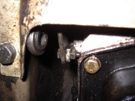

Hmmm... disregard that last post. I just went out and had another look and took another picture.
Download Attachment: IMGP2453b.JPG
83.22 KB
The picture shows the end of the connecting rod (on the left) and I can now see more clearly that the bushing appears to be OK - just blackened with dirt.
In the center of the picture is the part that (I think) should go into the bushing. Doesn't look to be anything wrong there, either. It feels like it would go back together if I could push it hard enough. So why did it pop out in the first place? Am I missing something here?
Also, there is a lot of side-to-side play in the connecting rod itself. Is this normal? The rod moves when I work the gear lever, so I know that it is still connected with the gear lever,  but does the play indicate that the bushing could have disintegrated at that end?
The connecter popped out of the bushing because the bushing is many years old.  Sure, you might be able to pop it back in, but it will come right back out pretty soon.  I recommend replacing all the bushings in the shift linkage assembly.  If that's not something you are comfortable doing, then take it to your favorite classic MB shop.
