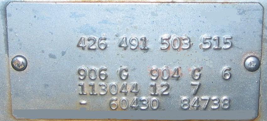

Hi group, newbie here in the process of purchasing a 113.
I am trying to find out the year/month of manufacture.  Does this plate have this information:
Or is it only from the VIN tag?
I have these numbers from the car I am looking at (this pic from the tech manual here), and I understand the last 5 digits are the body number, but is the VIN data on this tag such that I could find the month of manufacture in this table:
http://www.sl113.org/wiki/DataCard/USModelYear
Thanks.. many more Qs to come I'm sure

The table you found in the Tech Manual section shows the last 6 numbers of the VIN The 113 044 12 on the chassis tag tells us that the car is a 280 sl with left hand steering and automatic transmission, The VIN tag is on the left window post and the 6 digits that you are looking for start after the #12.
The color codes on the tag indicate the car is light blue metalic with a dark blue hard top and hubcaps.

Thanks Al.
So the VIN digits needed to tell manuf month are on the VIN tag/windshield post and not on the body tag shown in the pic, right?

Check the driver-side door threshold for a black & silver plate that's stamped with the manufacture date on the top right corner. That's one way. The other way is to cross-check the VIN against the chart in the database on this site that correlates serial numbers with production dates by month.

The body number will also allow you to determine if hood and top go with car. The body number is stamped on underside of hood and on top below rear window.
