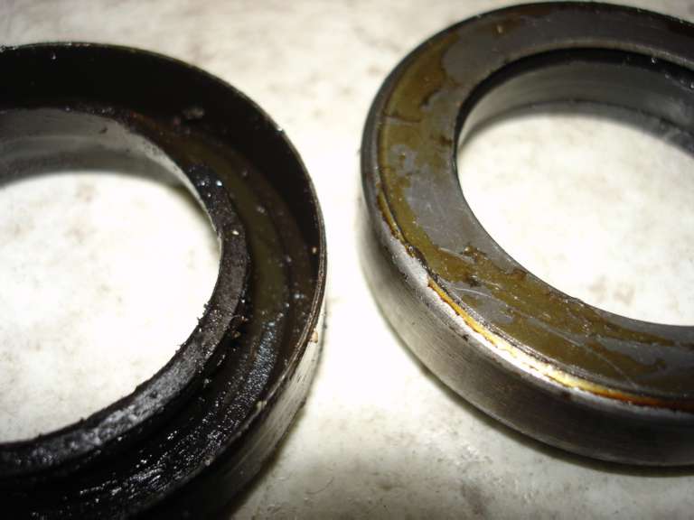

Update: I changed the pinion seal (how folks pry out the old seal without removing the entire front plate is beyond me!) and found that there was a slight difference between the old seal and the replacement. The old one has a metal backing (on the differential side). I'll post a pic later today. I went ahead and used the new one  anyway. Setting the torque on the crush bearing was tricky, but I think I got it right (surprisingly, the grooved nut did not require much torque to achieve the 24-26 inch-lbs flange turning torque....hmm...)

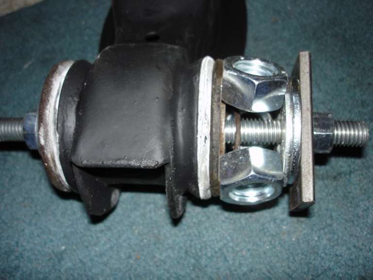

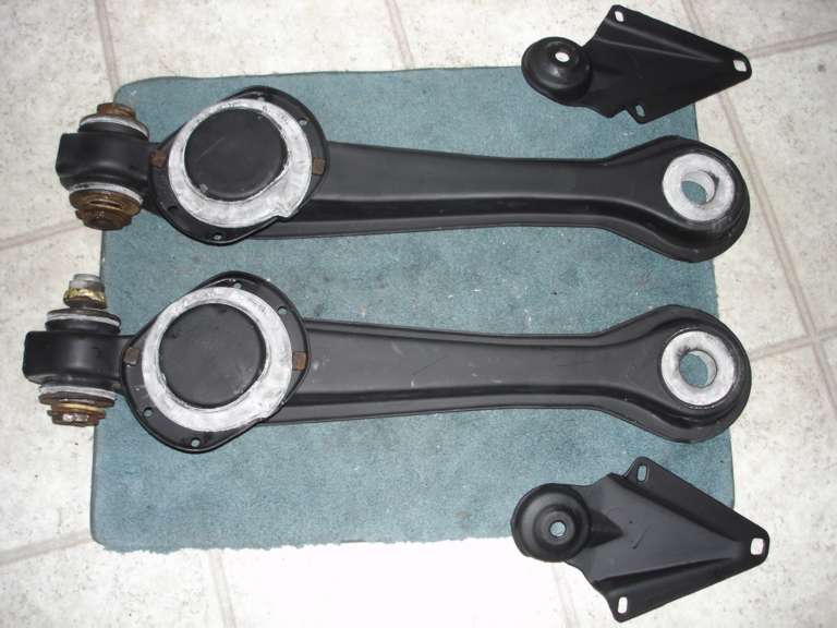

I mounted the new bushings into my newly painted trailing arms. The bushings on the axle side were much easier to mount than I thought. I used a long threaded bolt and some washers/nuts (same setup as my spring compresser h/w listed earlier) to compress the bushings and insert the lock ring (I trust re-using the old rings is not a horrible idea?)

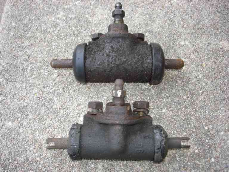

As I prepared my axle/jack rig thingy, I noticed the brake drum cylinders looked a bit corroded, so I thought I'd check the brakes out before installing the axles (easier to work on with everything out). Lo and behold! Both my brake cylinders are corroded tight, and the hand-brake pulley is also jammed (cables are fine). I pulled everything apart, and it seems I'll have to drill out the pulley fixture bolts. Ack! Why didn't they just use steel?!@?
Luckily, my drum setup from the old axle is working. I think the axle is from a ponton, as the diff ratio is 4.10, and the brakes are slightly different-- larger wheel cylinders, adjusting wheel, etc). The picture shows the 230sl cylinder (lower- thinner), vs. the old cylinder (upper- thicker):
Download Attachment: pagoda-brake-cylinders.jpg
52.79 KB
Anyway, I'm going to scavenge parts from there until I have time to refurbish the corroded cylinders and brake cable/pulley assembly. Anyone know if there is a cheap cylinder refurb kit available? (new boots, pistons, etc) Reasonable would be $10-20, since new cylinders cost only about $60...

The differential is probably from a W111 coupe, which also used the 3.75. Actually no ponton rear axle had a compensator spring. Those emergency brake cables will be longer if this is the case.
The wheel cylinders are in inch sizes! Just measure the internal bore and go to your local auto parts store. Ask for the size and not a certain car application.  If you get a good counter person he will be able to look up the diameters of the kits to find the right size for you. Save your hard parts to re-use and replace all the rubber seals with new. You should be able to find kits for just a few dollars. The modern seal materials will hold up much better than than the originals also.

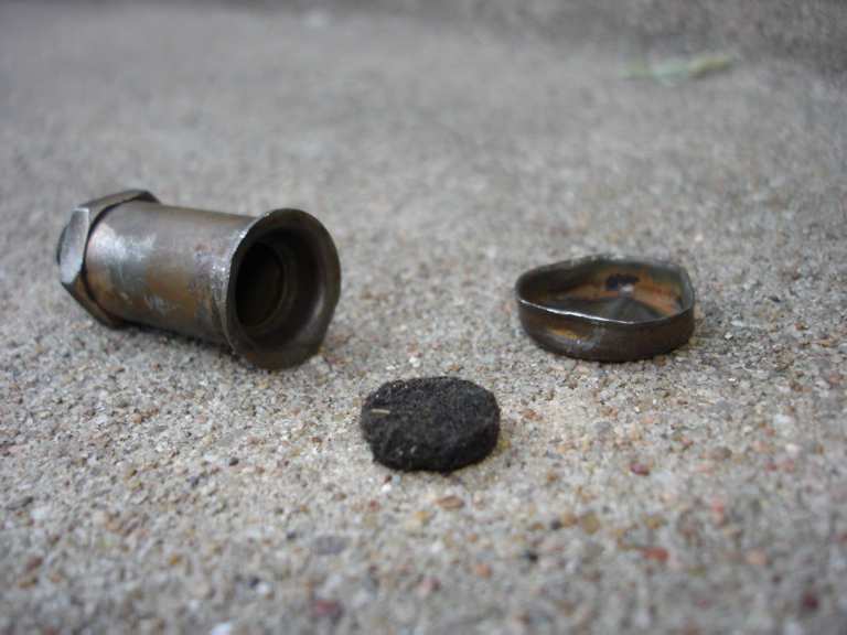

As per your suggestion earlier, I removed the differential breather tube and flushed it clean with degreaser (I use Marine Clean, as it's less toxic). However, there seemed to be an obstruction within the tube, so I pried open the top and discovered a little foam pad (an air/dust filter/guard?).
Download Attachment: pagoda-differential-breather.jpg
39.55 KB
It seems pretty gunked up. Any ideas for a suitable replacement pad?
