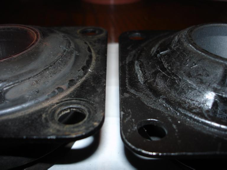

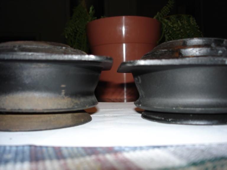

(1) When I removed the differential mount (trunk), it looked ok to me. In fact, the new one looks a bit different than the original. I suspect the new one (on the right) will lower my riding height by a bit (seems minor). Should I worry about alignment issues if I use the new one, or should I just play it safe and keep the old one?
Download Attachment: 113-diff-mount-sidebyside-close.jpg

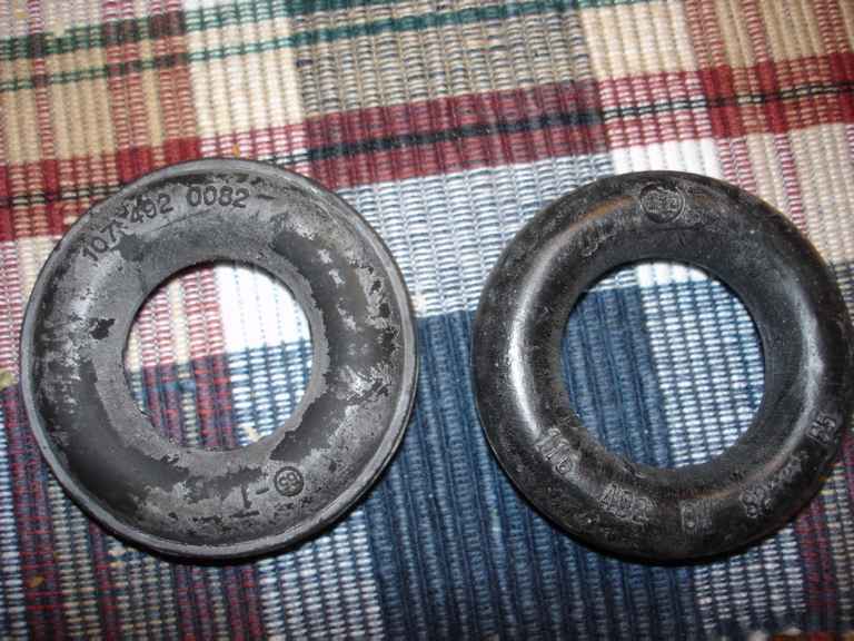

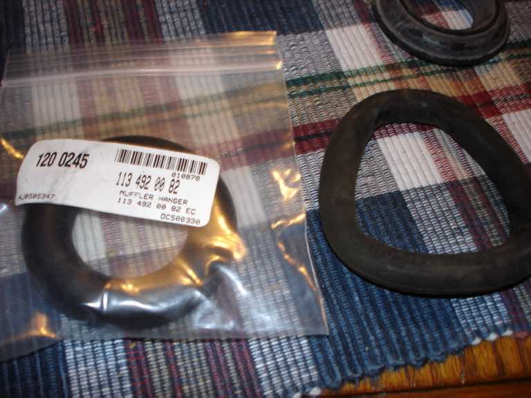

(2) The new muffler hanger rings seem different from the originals. For example, my old rings from the centre hanger look triangular (part # 113-492-0082), while the replacement rings are smaller and completely circular. Can these rings stretch so much?? Or did I get the wrong parts...?
Download Attachment: 113-muffler-ring-closup.jpg

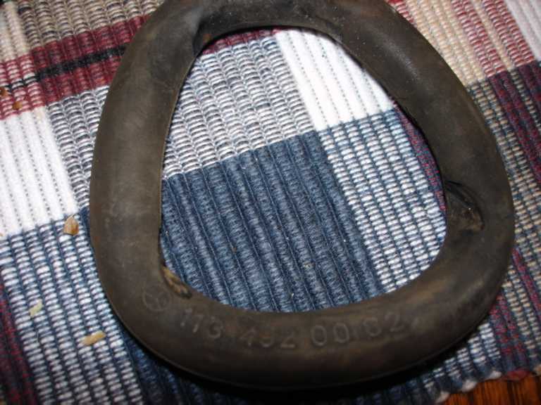

(3) My old rear muffler hangar rings were of two different kinds. What is the correct part number for these rings? #107-492-0082 (on the left) seems pretty soft, while #116-492-0182 (on the right) seems pretty hard... shouldn't they be the same??

The triagular shape of the old hangers is just the results of long term position memory of the rubber.....

Use the new diff mount, it will settle pretty quickly to a lower height anyway.  If it affects ride height at all, it will be by a very small amount.

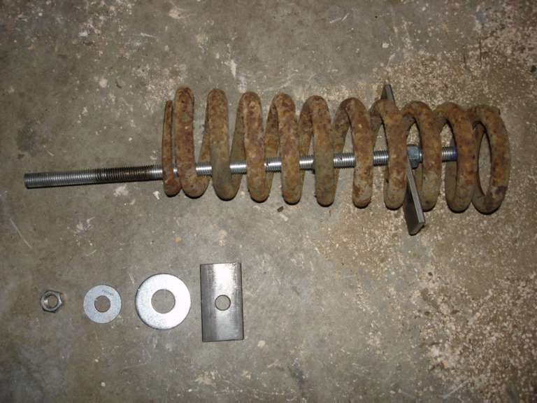

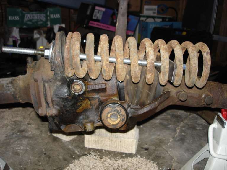

In order to remove the compensating spring, I had to make my own crude little spring compressor. Having never removed the spring before, I had no idea of the fully extended length of the spring (mine turned out to be 11"), and hence the amount of energy stored therein. All the commercial spring compressors I found had grappling hooks too thick to fit comfortably between the coils, and I felt uncomfortable grinding them down. Compounding things further was the close proximity of the petrol tank, pump and hoses. I then noticed that the differential side (left side) of the spring mount was hollow (had a through-hole). This gave me an idea. I used a 15" long 0.5" diameter threaded bolt (Home Depot, about $3/ft), some washers and nuts, and a couple of home-made metal plates.
Download Attachment: pagoda-comp-spring-parts.jpg
52.8 KB
The plate holding the spring (on the right in the photograph) is about 5"x2"x0.25", with a 0.5" hole drilled through the centre. The plate on the left is about 3.5"x2"x0.25".
(0) As a prerequisite, relieve as much tension from the compensating spring as possible. An old post by Joe Alexander mentioned removing the shock absorbers, and slowly lowering the axles, always keeping them fully supported. Also, slightly loosen the two spring mount bolts on the right (axle) side.
(1) slide the threaded bolt through the spring from the differential side of the mount (left to right).
(2) slide the 5" long plate through the spring, a few coil turns from the end, and slide the bolt through the plate.
(3) carefully slide a nut through the spring, on the right side of the plate, and screw-in the bolt until it almost hits the mount on the right. This was the painful part, but a thin pair of clamping pliers holding the nut really helped.
(4) place the smaller plate on the left side, along with any washers, and tighten with a nut. Be sure to grease the bolt threads on this (the left) side before tightening, as this is where the spring will be decompressed from.

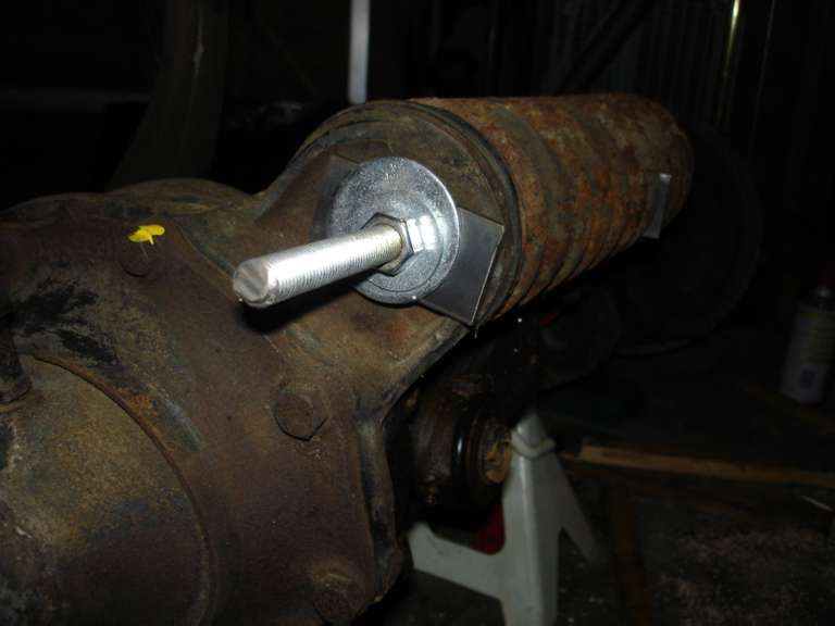

Download Attachment: pagoda-comp-spring-side.jpg
28.39 KB
(5) tighten the left nut until you hear the spring compress ever so slightly. now tighten a little more.
(6) carefully remove the two bolts (inner one first) holding the right mount, and remove the mount. The spring will now be compressed against the differential side mount.
(7) slowly loosen the left nut (remember the grease?) until the spring has completely decompressed (this is where the 15" bolt length comes in handy), and remove the spring.
Download Attachment: pagoda-comp-spring-rear.jpg
50.46 KB
Hope this helps,
Waqas in Austin, Texas

 << carefully slide a nut through the spring, on the right side of the plate, and screw-in the bolt until it almost hits the mount on the right. This was the painful part, but a thin pair of clamping pliers holding the nut really helped.
 ..you may want to cut a slotted hole on this plate so you do not have the problem of starting the end nut. or you may just use a little thicker plate and tap the hole...
 ..Good job, either way.

very clever method for removing the compensating spring, and thank you very much for posting pics and description!  I'll be trying it soon.

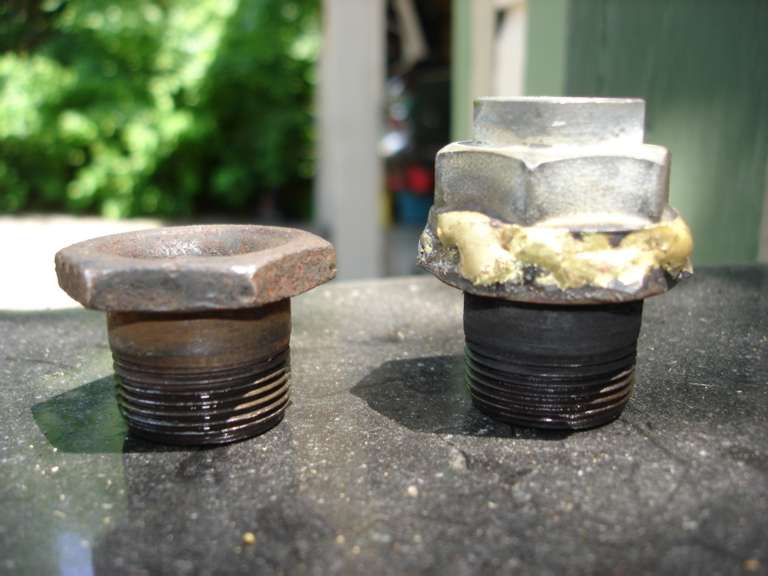

Speaking of guidance, regarding the breather tube on the top side of the differential, how can I make sure it isn't clogged?  (while the diff. is still out and accessible). It looks a bit oily around the edges...
Also, any recommendations for 'sealing compound' for the new pinion seal?

The vent can be unscrewed and flushed clean with solvents or replaced.
I like to use Permatex #2 sealing compound.

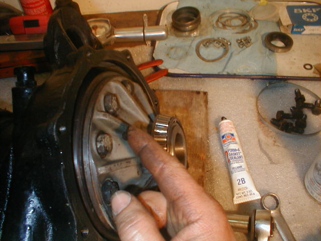

Download Attachment: permatex2.JPG
57.79 KB
« Last Edit: May 23, 2005, 23:03:08 by ja17 »

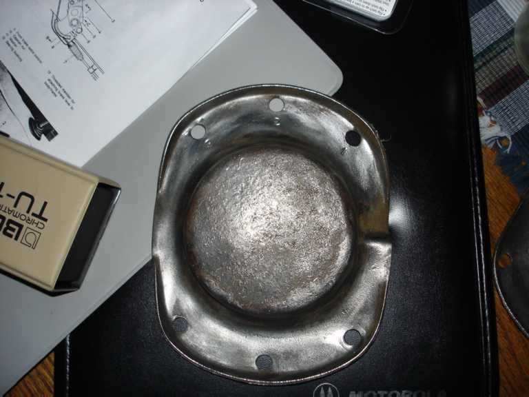

My springs are slightly different sizes (~5mm difference). I've no plans to replace them any time soon. Any recommendations as to whether I can successfully adjust spring height using the spring retainer adjustment holes?
Here's a photo of the spring retainer after grinding off all the rust/crap before I apply POR-15. You can see faint numbers (1,2,3) for what I assume are height adjustment settings. Can I make up for the difference by setting these differently on each side...?
Download Attachment: pagoda-spring-retainer.jpg

Regardless of spring dimension, you want to take ride heigth from the floor on both sides of the car.. this will tell how the springs are setting.
 The plate adjusters will only slightly change the height [ each click only changes camber 0 degrees 10', whereas a 3 mm addition on the  rubber on the comp spring will change 30'.
 Most guys using old springs just get new 6mm comp spring rubbers
 [ one on each end] and start from there.
 if the camber is out from each side , you can then tweak it in with

My snail's pace continues with this job. Somehow the scope keeps expanding, and new parts must be awaited with patience. My question of the hour: when I first removed the differential carrier/mount from the long connecting bolt, the bolt was covered in oil (this was the case for both old and "new" differentials). I initially assumed that oil must have seeped in from a leaky pinion seal or axle boot, but while reading section 35-5 of the BBB (cars starting 1968) regarding installation of the right axle supporting tube, I came across the statement "grease connecting bolt and slide through from the rear...". This implies that the surface between the connecting bolt and the tubular carrier mount must also be greased. Is this correct? Note that I'm doing this from the front (having left the connecting bolt undisturbed within the axle/differential hinge). So why was the bolt oily and not greasy when I pulled things apart? (or perhaps it was both and I did not notice) So do I use regular grease or something special?   (BTW the old tubular mount rubber was completely shot!)
