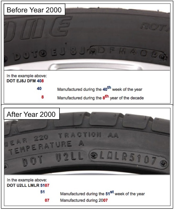

Many of us will buy our cars with older tires on them. Few will think to check the age of the tire or even know how to check tire age. The good news is that the information you require to be able to tell when your tire was manufactured is printed on the tire wall.
The format is 4 digits, which breakdown as follows:
  • the first two digits are the week of the year,
  • the second two digits are the last two digits of the year
For example: 4101 written on the tyre wall means that the tyre was manufactured in the 41st week of 2001.
There is no shelf life for tires so you'll have to make your own decision about what's safe and what should probably be replaced. However, it is recommended that you watch this short clip, which provides the sort of information one might like to be armed with in order to make a more informed decision:
http://abcnews.go.com/Video/playerIndex?id=4826897
Here is a different look of the tire information and how to determine the date it was manufactured.
