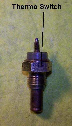

The "thermo switch" is a single terminal sensor which was used only on the earliest 230SLs and earlier sedan engines (described in the early BBB as version ll). The thermo switch was not used on any of the later versions. In fact a factory modification involved in disconnecting the thermo time switch and leaving it unhooked along with other modifications (for more info see the Engine Starting Aid Tour). It functioned by providing ground (earth) to a relay at temperatures below 113 °F (45 °C).
Thermo Switch
