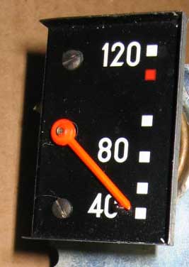

Normal range
167203 Fahrenheit or 75-95 Celsius
Maximum
239 Fahrenheit or 115 Celsius
White boxes (Degrees Farenheit) 100, 140, 176, 212, 248
White boxes (Degrees Celsius) 40, 60, 80, 100, 120
