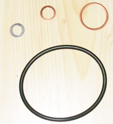

Oil Filter Operation
Oil Filter Seals and parts
Oil Filter Seals
Standard Filter Seals in kit (see list)
Oil filter MB 000-180-00-09. It comes with one new large o-ring and the copper seal ring for the engine oil drain plug. See the list below for the additional seals
Additional Seals
There are three other seals that do not need changing every filter change but do deteriorate with time and need to be changed. They are shown in the picture, below the standard seals provided in the filter kit. The garden hose type seal fits on the filter head and seals the top of the oil filter element to the head (If its not there, you may not be getting 100% filteration). The donut looking seal fits at the bottom of the filter cannister. On inspection, this one feels very hard and may have a 'fried' look. The last one is in the bolt hole of the cannister. If nothing else, it holds the bolt in the bowl when you undo it and keeps the hot oil from burning up your hands.
  • A tubular rubber seal: MB 000-184-33-80
  • A rubber seal in the bottom of the canister: MB 000-184-17-80
  • A small flat rubber seal: MB 000-184-32-80
