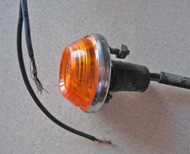

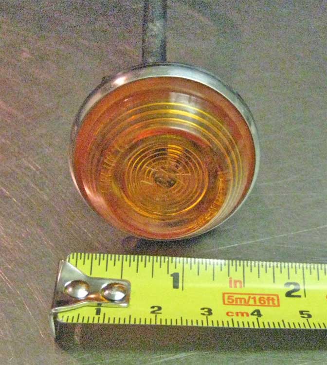

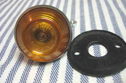

Electrified Marker: The marker is slightly more than 1.5 inches (4 cm) in diameter. The orange plastic “button” shaped top is tightly crimped into a thin, satin finished steel base. The two mounting bolts topped by holding nuts are permanently fixed to the base on either side of the central bulb holder.

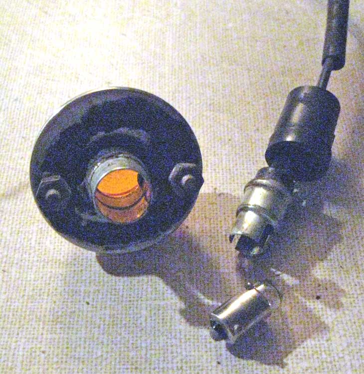

The bulb is similar in size and shape to the 2 watt bayonet base bulb used for the dash instruments. The wattage of the marker bulb has not been verified.
Two wires (Black and Green) are attached to the socket. The wires are about 20 inches (50 cm) long to reach from the marker to the headlight.

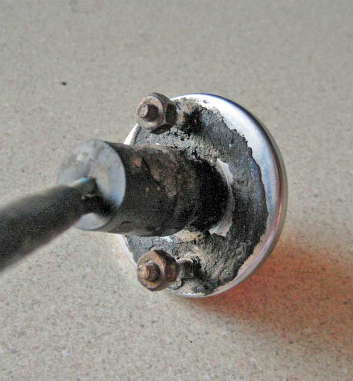

On an original set of markers, the remains of black rubber was observed on the marker base possibly as a water barrier and to avoid a reaction between the marker and the painted surface. The assembly is steel. Rust has been observed on original markers when removed.
Bulb is accessed by pulling off the rubber fitting surrounding the socket then gently twisting and pulling the now exposed bottom of the socket. The entire socket and bulb will come free.

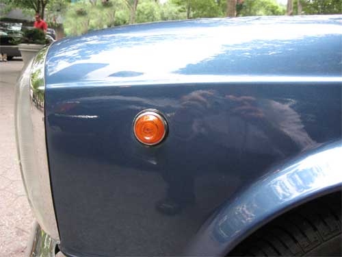

The marker is positioned on each front fender about 6 inches (15 cm) in from the front edge of the fender, and about 2 inches (5 cm) below the ridge that runs along the side of the fender.

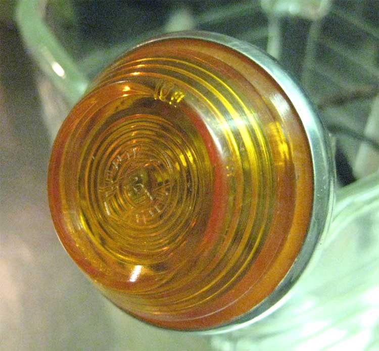

In 2008, similar markers are available from European part suppliers. The same markers were used on Fiats and other Italian cars.

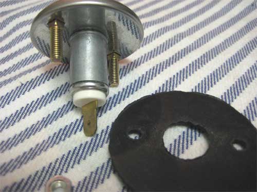

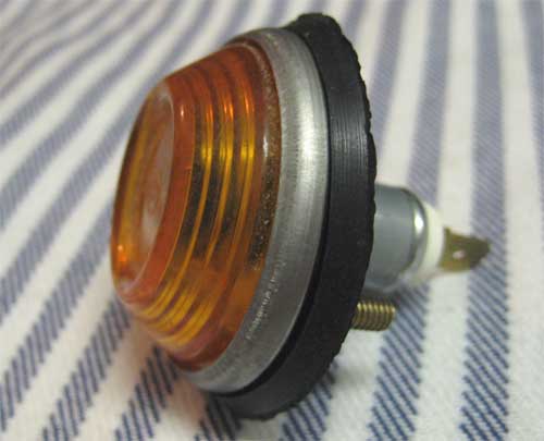

The modern substitute marker is a near perfect look-alike but appears to be of lesser quality in construction and material. Comes with a rubber grommet to go between the light and the car body.
Views of a modern Fender Marker of style similar to the original:
