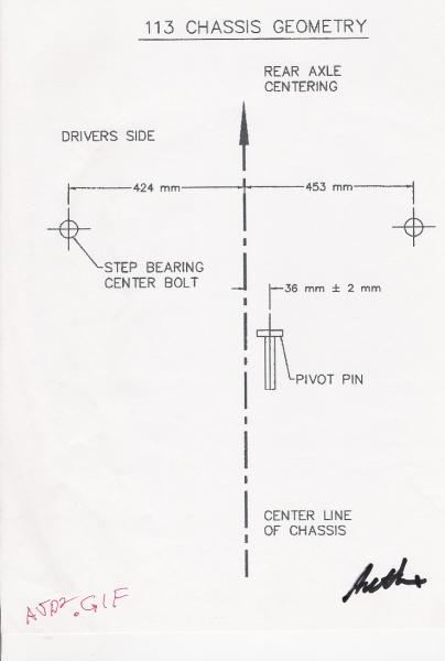

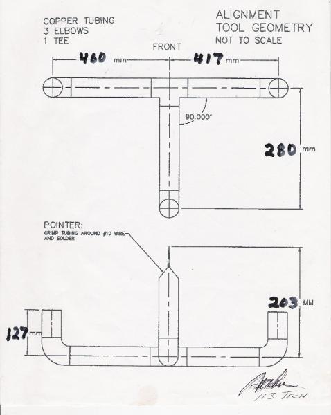

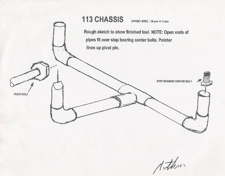

Alignment Tool
If the rear axle is removed, it will have to be re-aligned on installation. Arthur Dalton came up with an easy-to-make alignment tool made out of standard copper pipe fittings, soldered together. If you can sweat pipes, you can make this fixture. Here's how
Arthur's notes on constructing the tool follow:
  • Easy way to make tool is to set up geometry on 2'x4' plywood
  • Screw in some screws where step-bearings measurements are, leaving heads 1/2" protruding out to slip tubing over
  • Drill hole in wood for pointer wire at proper dimension
  • Assemble all pieces by hand and when in place on ply template, solder all joints. Unit is now perfectly set.
  • When making tool in this manner, offset is is reverse because tool is being made upside down
  • When making ply, reverse 466mm and 411mm
  • When tool is uprighted it will then be in proper geometry for use
  • Tool can be used without even jacking up car for quick checks

Rear axle centering tool
Anyone interested in plans for making a pivot point rear axle centering gage, I have made some up. Easy to make, about $5 worth of tubing. Send me an email and I will scan plans for members.
An added note for assembly, I have found that by laying out the geometry on a piece of plywood and installing screws at the step bearing and pivot points allows you to set the tubing over the screwheads and then solder all joints at one time. This assures accuracy and simplifies construction. The trick here is to flip the pivot measurement to the other side of the line as you are assembling up-side down. When done and flipped over, it is correct and ready. Any fine-tuning can be done by tweaking the pointer.
