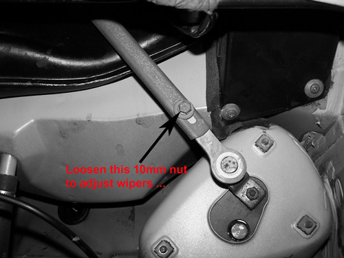

Adjusting Wipers
Loosen the 10mm nut on the output shaft of the wiper motor (right side, under dash). Turn the wiper motor on and then off again to ensure that the wiper motor is in the correct “stop” position. Move the wipers to the correct position, slightly above the window molding. Tighten the nut. It may take a couple of tries to get it just right…
