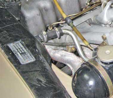

On a Euro version car, the Data Plate is located on the right center of the firewall. If a Data Plate is located on the firewall, the car is an original Euro version car. The data and emissions plates installed in the door frame of a USA car are not found on a Euro car. The Data Plate located on the inside top of the left fender is in both USA and Euro cars.
Here is a Euro Data Plate in its firewall position.

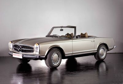

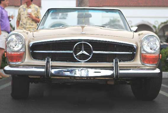

Compare these typical cars: Above is the Euro version. Below is the USA model. Note the Bumper Guards and the Headlights.
___________________________________
Here are two side views:
Note the Fender Markers, Headrests, White Wall tires, Bumper Guards on the USA version (lower photo). The Euro example has none of these except Headrests, unusual for a Euro car.
