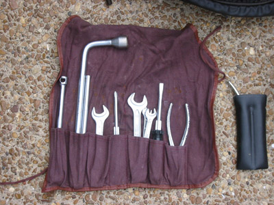

The above toolkit is from a 280SL and believed to be complete.

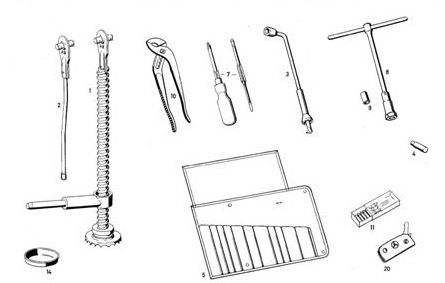

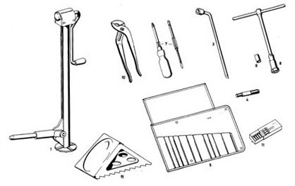

An incomplete illustration of tools and the pouch is in the owner's parts book and the dealer parts book. Many of the much more common sedans of that era had the same tools in their tool kits. Do note that many sellers on eBay try to pass off very common sedan toolkits as much rarer W113 toolkits in order to fetch higher prices. The biggest giveaway is the much nicer vinyl tool pouch on the SL's. The locking pliers are another item unique to the SL tool pouch. Many of the tools in the kit are not shown in the dealers parts book illustration:
230SL Toolkit
250SL and 280SL Toolkit

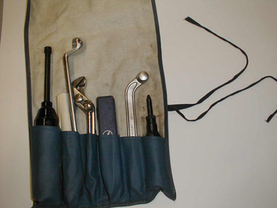

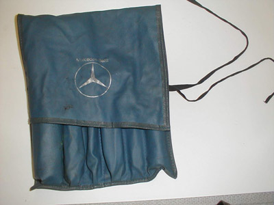

The 60's and 70's sedan tool bags were mostly canvas (early were green and later red) with string ties. Many of the tools in these kits were the same tools as in the W113 tool kits. The unique items in the W113 kits were the long handled "channel lock" style pliers, and the plastic fuse pliers on the later W113 cars. The spark plug wrench for the fuel injected SLs and sedans of the era was a bit different also.
Around 1975 some of the tools in the cars became more cheaply made. Mercedes-Benz still used the red canvas tool roll. The pliers are noticably lighter duty, the lug wrench is dual function and the seperate spark plug wrench is gone. The wrenches seem to be of similar quality but sometimes of different manufacturers in these kits.
Sometime during the W107 SL production the snap tool roll became history. The later W107 SLs (450SL etc.) used the cheaper red canvas tool roll.
