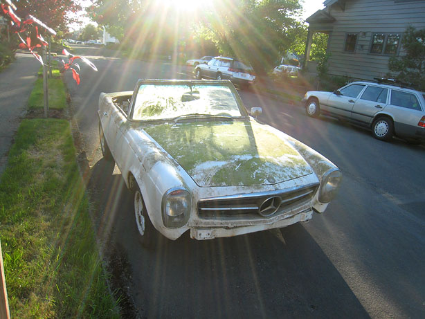

I haven't taken a whole lot of photos along the way, most times I'm just trying to figure out what the heck I'm doing and only afterwards realize I should have taken a picture!
I did figure out the stalling-out problem after the car hits high rpms and I have bjudd to thank for that.  His post "8 drops of magic" reminded me to oil the distributor and sure enough, the problem was that the advance wasn't coming back to normal soon enough.  The car is now actually running very well!
Took the car for a little spin, 100 feet down the street and back, the car does shift and brake,  I took a razor blade and cleared a spot on the windshield to see out of, my neighbors got a laugh out of that....[:p]

The weather was so nice today that I got a little bold and decided to drive the car back home from my shop.  It's only 11 blocks but I haven't gone through the braking system yet so it was something of a risk.  Somehow I felt like the car would be ok and sure enough, it did great.  Took it back to the shop after dinner and this thing really seems to be running well.  Going to get those brakes gone through and take it for a longer drive.  Here's a fun picture of it on its first trip out as a running driving car.  Methinks the Gods are smiling on it.

That green "patina" does look cool.

Is that the famous "Moss Green?"

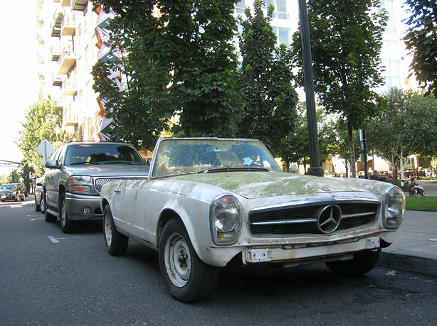

Back on the road! ...even if I still haven't washed the car...
I ended up finding a donor axle assembly from a 65 sedan and swapped it out with the information I've found on this forum.  Drove about 20 miles with the new setup today and everything seems to be fine.  I figure I missed about 2 months of Summer but it's better late than never.   Life is good!  :)

At any rate, I think I was so anxious to sort the car out mechanically that once it was I hit the road immediately!  I found that the car actually attracts quite a number of people pulling out their cell phone cameras wherever it's parked.  I think that the car looks like such a heap that folks must wonder how the thing is roadworthy at all!   I have to admit that it's become a huge source of amusement for me.  I love the idea of a car that looks so bad cosmetically but is totally dialed in mechanically, it's just funny.
