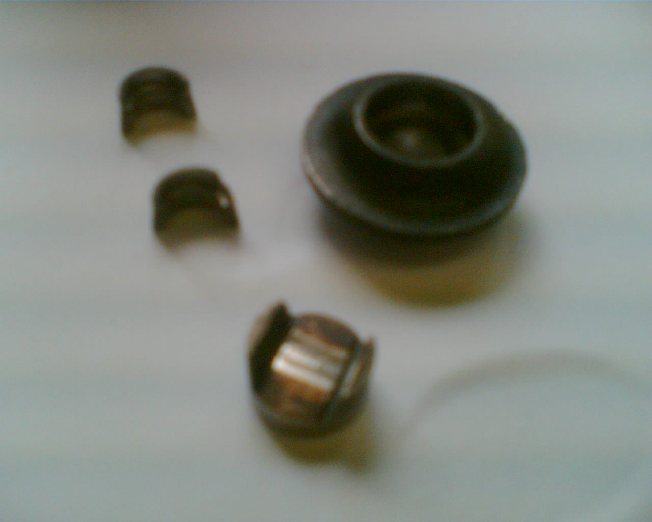

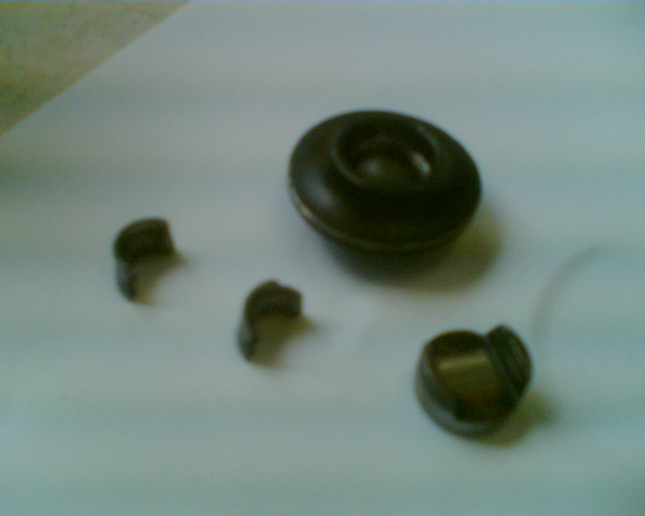

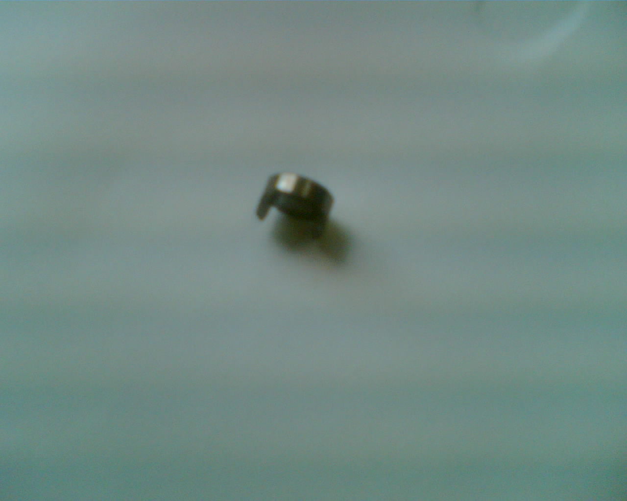

Pics of bits and pieces - one of the replacements was flown in from Argentina and they cost a total of appr. USD 120,- incl. VAT
They were completely worn through - probably already years ago which corresponds with the previous owners statement that the sound had been there throughout his ownership.
