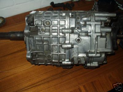

Ive just bought 3 getrag 265 overdrive boxes and am having conversion kits made up by an engineering firm. The cluch of the 280 fits the splines so thats no problem. Ive tried to get a spigot bearing with a smaller center but cant, so it seems that you need a sleeve for input and output shafts. The adaptor plate is 15 mm thick. When ive finished this and road tested it ill post all details.  If you want to email me, we could swap ideas on this conversion. Ive already converted my 230sl to 2.8 5 speed manual, but i used a 280se doner car which had the 3 side linkages and needed a large piece of transmision tunnel at the side and bottom cut out. This conversion will be good for 111 series as well. Ive put a picture of the overdrive box showing reverse light switch on the very top left. I think that is the way to tell that its not a dogleg 1 to 1 fifth box if your buying over the internet.
