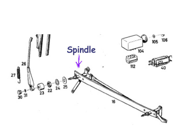

While your in that area I recommend you clean and lubricate the wiper spindles.

What would you lubricate the unions of those wiper spindles with. And for that matter what exactly do you mean by spindles? The connecting joints? the drive rod comming from the wiper motor?

Here is a pic to give you some help.  The wiper blade shaft will bind over time with excessive use and without lubrication.  If I remeber correctly there is a c clip which holds the shaft in place.  It can be accessed by removing the wiper arm.  Once the clip is removed the wiper shaft can be removed from the underside of the dash, cleaned, lubricated and reinstalled.  The job is easy to do and a nightmare if your wipers seize.  You already know how much work is needed to get to this area.
Download Attachment: spindle.jpg

Thank You, that helps a lot. I'll get at it this week i hope.
