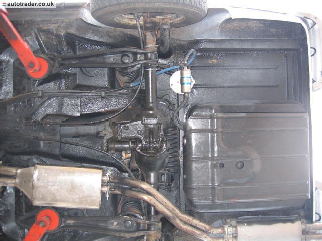

Originally posted by rmmchl
i don't believe these tank hold 21 gallons--------------i know what the manuel says, but I'm being honest-I'll fill up when it looks like its on empty and only put no more than 14 gallons in.
You must have a 230????
230 Fuel Tank:
280 Fuel Tank
« Last Edit: July 02, 2007, 06:52:00 by naj »
Re: Sending Unit
« Reply #27 on: July 02, 2007, 09:54:17 »
Mine is obviously the smaller -- similar to Naj's first picture but with spare tire poking out.
It takes just about 17 US gals. My reserve is at least 2 maybe 3. can't speak for the bigger ones.

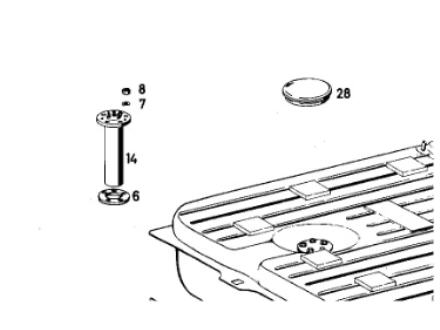

New user to the forum - the gas gauge on my 1970 280 is doing quite a dance; up, down, hold, up, down, etc.  I'm definitely not a mechanic by trade, but I'm not uncomfortable holding a wrench; how difficult is pulling the sending unit for inspection and possible cleaning?
Gary
Re: Sending Unit
« Reply #31 on: October 30, 2007, 15:54:37 »
Gary,
Pulling the sender is easy in these cars.  There is a plug in the center of the trunk area.  Under the plug you will find the sending unit.  Here is a diagram of what to expect.  The sender is comprised of a float suspended on the sides by very thin wires.  As the float rides up and down on the fuel level different impedences are fed from the sender to the gauge to denote fuel levels.
Download Attachment: Sender.jpg
