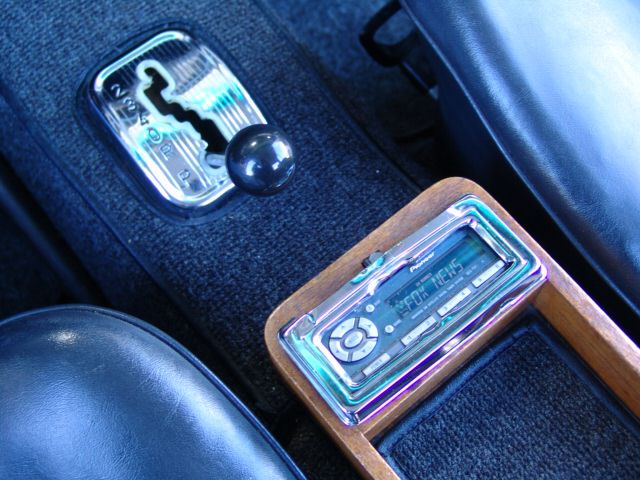

where did you install the XM radio? In the ash tray as shown in this picture? [I copied that from a 230SL on eBay: Item number: 170073981945].  And where is the antenna?

Hi, Alfred,
In the first photo in this thread: http://www.sl113.com/forums/index.php?topic=3788 you can see the Becker radio in the dash, and the XM radio in the center console.  If you look closely, you can see wires coming out from under the ashtray lid to the radio.  I ran power, antenna, and the radio connection wiring under the carpet and up through the ashtray, so that when I remove the the XM radio I can push the wires back into the ashtray and there's no sign of anything unusual.
In one of the other photo you can see that I have a rear wind deflector.  This wind deflector has a black panel that sits over the parcel shelf and supports the plastic shield.  A very small (and unmarked) XM antenna is velcroed to the top of that panel, and is almost unnoticable.  (I had folks at Blacklick stand next to the car and ask where the XM antenna was.)  If I wanted to remove any sign of the antenna, I could pull it off the panel and drop it below one side of the parcel shelf.

Thanks David!
The wind deflector support panel looks like a good place for the antenna. Do you notice a loss of signal with the soft or hard top up?

Hi, Alfred,
Certainly not with the soft top up.  I don't believe that I've had the hard top on since I installed the XM radio.  Best of luck!
