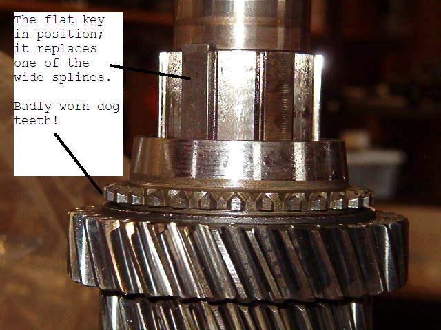

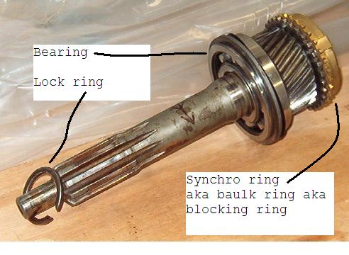

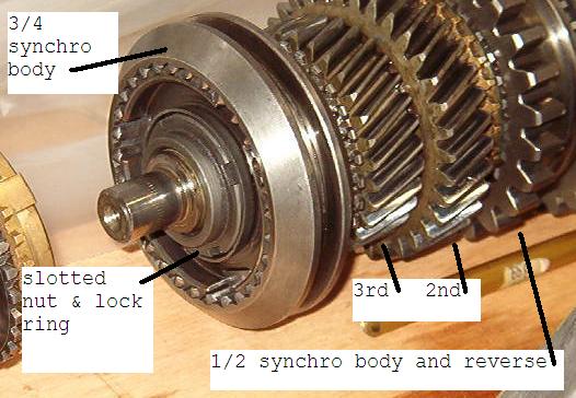

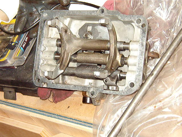

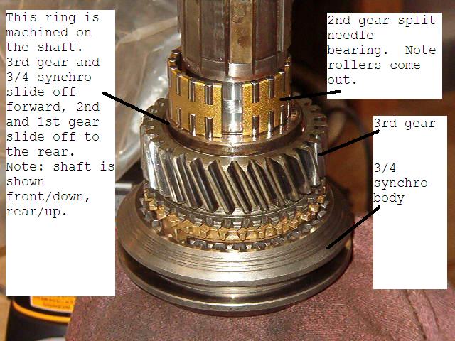

I'm rebuilding my 4 speed transmission.  Here are a few thoughts and some pics.
It's not a bad job, as long as you don't drop the tranny while removing it.  It's fairly heavy and a trans jack or a strong friend are pretty critical.  The upper bellhousing bolts are accessed from inside the car through the upper access panel in the transmission tunnel.
The trans is pretty straight-forward to disassemble, at least as far as I took it.
Trick 1 is that the countershaft (layshaft) has to be lowered in the case before the input shaft can be removed.  It's not hard, just remove the countershaft bearings, which are slip-fit, and the shaft drops.  Then remove the input shaft, mainshaft and countershaft.  All bearings are slip fit.
Trick 2 is the needle roller bearings for 2nd gear.  This is not the usual caged roller bearing, it's a split bearing and the rollers are not caged.  If one is not careful when removing 2nd gear, the bearing halves and rollers fall out and go everywhere.  To avoid this, mount the mainshaft vertically, then carefully lift off 2nd gear.  When you have room to get your fingers in there, hold the bearing halves in place and finish removing the gear.  As long as the bearing halves are held in place, the rollers can't fall out.  While holding the bearing halves in place, turn the mainshaft horizontal and take off the bearing halves.  Don't tip them or the rollers will fall out.  The other roller bearings are caged, so they're easy to handle.
I'm working on the trans because it hangs up in 3rd gear, but only after coasting.  I suspected excessive end-play on 3rd gear and believe now that I was correct.  3rd gear will have excessive end play if the slotted nut on the front end of the mainshaft comes loose, as mine was.  The lock ring that secures the nut does not actually prevent loosening of the nut, it simply limits the rotation of the nut to a few degrees if it does come loose.  But a few degrees rotation is enough to allow more end-play on 3rd gear.  I'll use loctite when the nut is retightened, in addition to the lock ring.
Replacement of the speedo shaft seal is covered in a separate post.  There is also a seal on the main shift rod, but I didn't disassemble the shift linkage in the top cover of the tranny, so this seal won't be replaced.  Since it's at the top of the trans, I'm not worried about it.
My overall (amateur, first timer) observations are that this is a simple and robust transmission.  The only fault I find is that the lock ring does not positively prevent loosening of the mainshaft nut.
Pics follow
Input shaft
Download Attachment: trans-inputshaft-sml.JPG

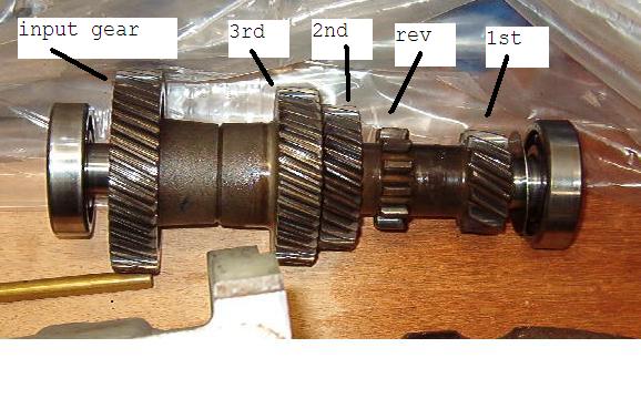

Countershaft (layshaft)
Download Attachment: trans-countershaft-sml.JPG
45.93 KB
Mainshaft, showing slotted nut
Download Attachment: trans-mainshaft-sml.JPG
46.5 KB

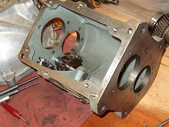

Transmission case, showing reverse idler gear

Trans top cover and shift forks
Download Attachment: trans-topcover.JPG
73.84 KB

Jeff, you're welcome!
Joe, thanks for the advice, I'll double check the key.  It seemed ok, but I'll look closer.
Ben, all four of the main bearings are ball bearings, as are the replacements I ordered.  I assume they are angular-contact (thrust) bearings, I'll double check that when I reassemble.  And yes, I've noticed the exploded parts drawings have the input shaft bearing backwards - an early case of cutting-and-pasting the wrong picture!

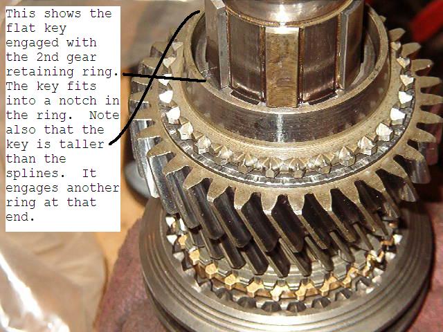

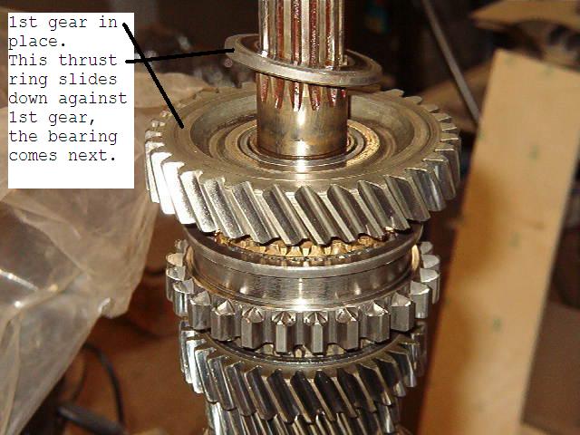

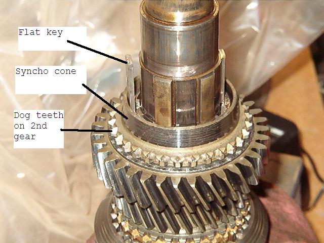

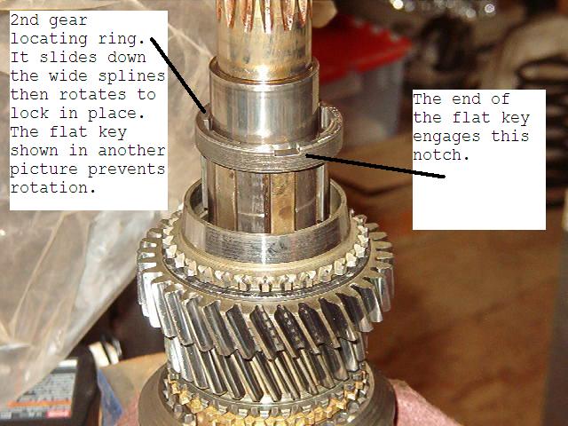

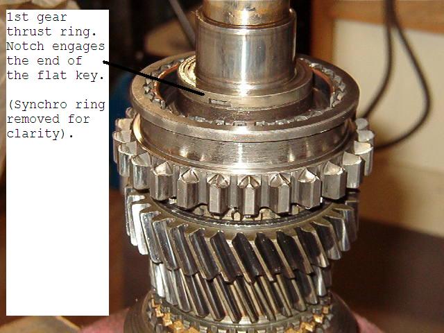

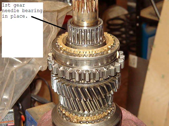

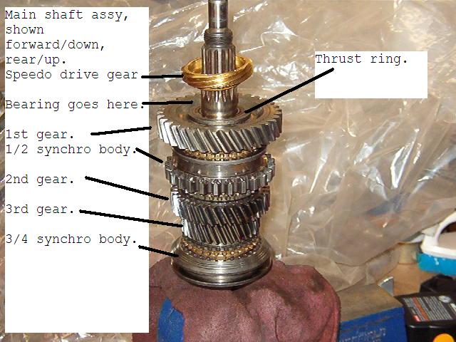

Mainshaft assembly pics.  The first and second pics are out of order, the second pic should be first.

Hi George,
This is great stuff!  Thanks for posting the info, along with all the nice pics!  Working on the car and taking pics at the same time is not always easy...  especially when the hands are greasy, you are deep in concentration on the job at hand... and then to take pictures on top of that...
Thanks again!

Great job George, nice photos and documentation. This should be a George Davis "standard transmission tour"!
I use some wheel bearing grease to keep those needle bearings stuck in place during assembly. You can use a standard hose clamp to keep the gear cluster together snug, during the cluster installation into the gearbox. This will keep the flat key engaged in the slot of the thrust ring.
You can see how a loose slotted nut on the transmission output shaft will allow the gear cluster to come loose allowing the flat key to dis-engage. I find that the synchronizers are usually in good shape. A loose slotted nut usually causes the shifting problems. Worn Dog teeth  on the fourth gear may eventually cause a transmission to jump out of gear. Also as Dan C. has mentioned shim to reduce play in the output shaft or the transmission may also jump out of fourth. If you replace the fourth gear/output shaft,  save the bad one in makes the best clutch alignment tool possible.

George,
In your previous post, you mention that the gears have "rounded off teeth".  Could you explain why rounded teeth make it harder to shift?  It might seem to an uninformed person (like me) that rounded teeth might make it easier to get the gears aligned and meshed???
Craig

Re: 4 speed transmission internals

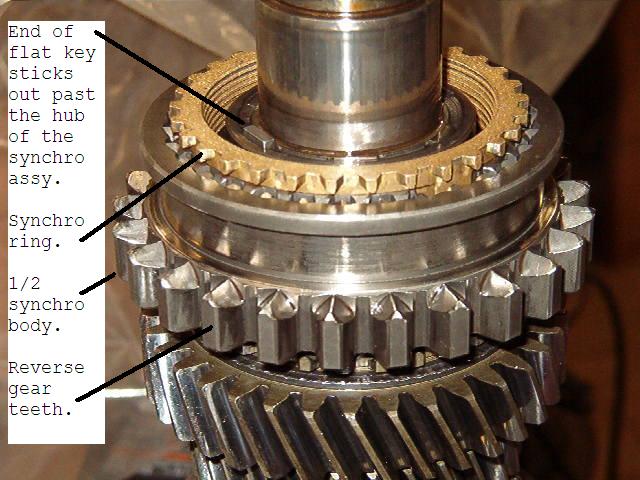

« Reply #14 on: January 07, 2007, 16:23:09 »
Hi Craig,
Sorry if you already know this stuff, but I'll give the whole story.
When a gear is engaged, the outer sliding ring (slider) on the synchro assembly is slid toward the gear you want.  As it slides, the synchro ring (aka blocking ring) which is between them does two things: it acts like a clutch to make the gear come to the same rotating speed as the slider, and as long as there is a speed difference, it blocks the slider from further movement.  Once the gear and slider are rotating together, the synchro ring now rotates slightly and allows the slider to continue sliding so that the dog teeth and inner splines on the slider can engage each other.
Odds are the dog teeth and inner splines won't be exactly aligned, so they are made with sharp edges where they come together, something like this:  >  <.  Image those two shapes moving toward each other.  This pointed shape allows them to meet and slide into alignment smoothly by pushing each other to the side.  Once they wear and become rounded off, they can't do that as easily as they can when they're sharp, sort of like this: )  ( .  Up to a point they can still push each other aside, but it becomes more difficult the more they are rounded off.
Hope that helps!

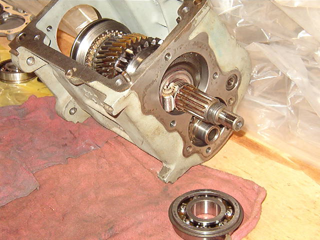

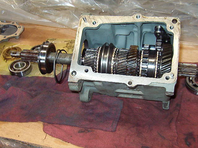

It's finally done...
All parts finally arrived, except the front seal.  Fortunately, it's a standard seal and a local bearing supplier had one.
Prior to reassembly, I did measure the clearances for the bearing shim rings.  It's not hard to do with the main case empty so you can stick a feeler gauge through the bearing holes.  One set of shim rings had a bit more clearance than the book spec, but heck, the transmission ran for nearly 40 years that way so I just went with it.  The rest were good.
Assembly involves first laying the countershaft in the case, but without the bearings.  Then the mainshaft assembly is put in place, also without the bearing.  In the pic notice the hose clamp on the main shaft.  The clamp holds the assembly together while you're handling it, otherwise the parts will slide apart, which is not good.  (Clamp suggestion courtesy of Joe Alexander!)
Download Attachment: FInalTrannyPics 005.jpg
69.77 KB
Then slide the input shaft in from the front of the case and marry it up to the mainshaft.

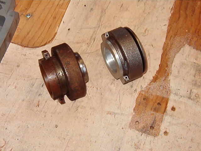

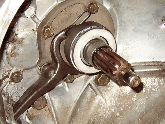

The pics below show the clutch release bearing and fork installed, with two clips that hold the bearing to the fork.  The other pic shows the old and new style release bearings.
Download Attachment: FInalTrannyPics 007.jpg

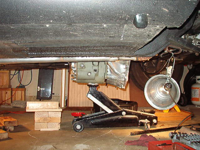

Download Attachment: FInalTrannyPics 010.jpg
73.63 KB
There are some really bad ideas in the preceding pic: a floor jack can't go high enough, and the trans is nowhere near stable enough even if it did.  The wooden block assembly was used, with the block on the jack saddle, and the trans on the block assembly.  That kinda sorta worked, but not really.  I had delusions of doing this all by myself, but there was just no way it was going to happen.  Too unstable, had to use both hands to stabilize the trans on this wobbly mess, which meant no hands to jack up/down or move the jack.  My wonderful wife finally happened by and joined me under the car on the cold, cold floor as my jack operator.  Together we wrestled the box in with only minor injuries.  If you take away nothing else from this write up, take this: that transmission is heavy, and dropping it on your head will really louse up your day - use a proper transmission jack.

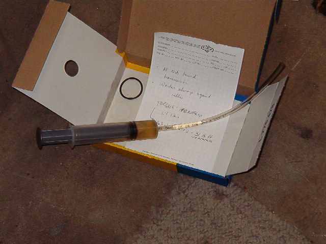

After everything is reassembled, time to fill and bleed the clutch.  I used a plastic syringe filled with brake fluid.  Make sure the pedal is fully up, then open the bleed screw and pump fluid into the bleed screw.  Close bleed screw.  Check for fluid in the reservoir, then do the syringe thing again with less fluid so you don't overflow the reservoir.  Test the pedal.  No go.  Suck brake fluid out of the reservoir into the syringe, get back underneath and pump it in through the bleed screw again.  Try to minimize the amount of air you push in.  When nearly all brake fluid has been pumped in, stop and suck a wee bit back out.  I got a bunch of air that way, I guess it sort of gathers just below the bleed screw.  After that it worked just fine.
Download Attachment: FInalTrannyPics 012.jpg
58.97 KB
Then I filled the transmission with ATF, got the car down and hoped like heck it would work.  To my great relief, it did.  Took the car for a little test drive, and will drive it to work soon.  I'll report on how the 'box is after a bit of driving, but for now I'm just happy to be done and relatively unhurt.
This is a good one! [:p]

Naj and Ben, thanks.  I tried to use a pump oiler first, but it didn't like brake fluid.  Spotted the syringe and it worked like a charm!
