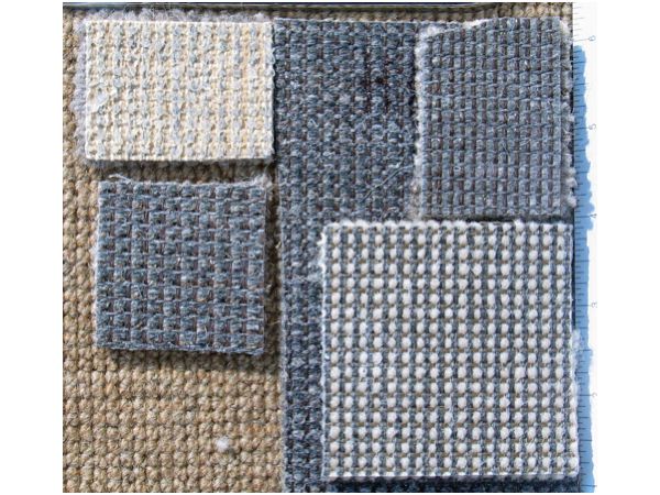

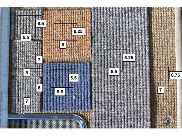

....  Since square weave was used in nearly everything German of the era, many folks make the mistake of assuming it is all the same.  However, M-B specified the finer weave.  When you put the two side-by-side the difference is quite noticable  .....
As usual Vince is correct.  When I searched for carpets for my car I wanted to have the same color as the original (#6434 'cream') and asked several of the vendors to send me samples. That's when I noticed that there are large differences. Because I couldn't get the original color any longer I chose a carpet with the finest weave. For those who are in the market for a new square weave carpet, here is what to expect:
The carpet in the background is my original, it has 7 loops per inch horizontally (I believe the weavers call this the weft), with 6.75 repeats vertically (the warp), so it is almost square.
One of the more popular vendors on this site sent me the carpet with the lowest number of loops (in both directions). Of course, some may prefer a coarser weave than others but I think that the fewer the loops per inch the lower the price should be  since it takes less yarn.
Another difference is the backing. The white samples has a heavy glue backing and I am wondering why this would be necessary.
Whatever one buys make sure it is a car carpet  and not one for the home.
